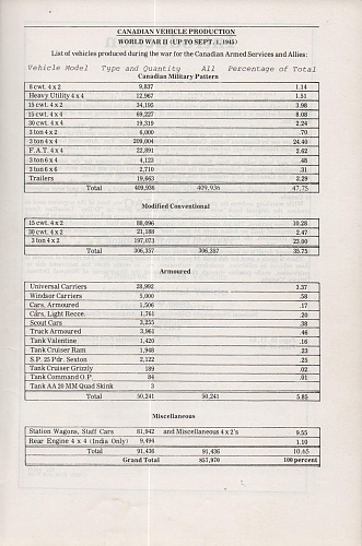

I am not sure how these figures are going to come out so here goes:
TOTAL CANADIAN MILITARY PATTERN TRUCKS [per Dr Gregg]
8 CWT. 4 x 2 9,837
HEAVY UTILITY 4 x 4 12,967
15 CWT. 4 x 2 34,195
15 CWT. 4 x 4 69,227
30 CWT. 4 x 4 19,319
3 TON 4 x 2 6,000
3 TON 4 x 4 209,004
FAT 4 x 4 22,891
3 TON 6 x 4 [FORD] 4,123
3 TON 6 x 6 [CHEV C60X] 2,710
TRAILERS 19,663
TOTAL 409,936
ALTERNATIVE C.M.P. PRODUCTION FIGURES
TYPE DRIVE MODELS QUANTITY
8-cwt. 4 x 2 C.8, F.8 937
8-cwt. 4 x 4 C.8A, C.8AX*?,
F.8A 12,967
15-cwt. 4 x 2 C.15, F.15, C8AX*? 34,195
15-cwt. 4 x 4 C.15A, F.15A 69,227
30-cwt. 4 x 4 C.30, F.30 19,319
3-ton 4 x 4 C.60S, C.60L,
F.60S, F.60L 209,004
3-ton 6 x 4 F.60H 4,123
3-ton 6 x 6 C.60X 2,710
FAT 4 x 4 C.-G.T., F.-G.T. 22,891
Rear engined chassis 4 x 4 Ford 9,494
Armoured car 4 x 4 Fox 1,506
Recce car 4 x 4 Otter 1,761
Scout car 4 x 4 Ford Lynx 3,255
Armoured truck 4 x 4 C.15-TA 3,961
Trailers 19,663
* I estimate C8AX production at over 905 units.
GM of Canada also supplied Ford Motor Company of Canada with 11,516 sets of fabricated cab sheet metal.
TOTAL MODIFIED CONVENTIONAL PATTERN TRUCKS
15 CWT. 4 x 2 88,096
30 CWT. 4 x 2 21,188
3 TON 4 x 2 197,073
TOTAL 306,357
TOTAL ARMOURED VEHICLES
UNIVERSAL CARRIERS 28,992 [FORD]
WINDSOR CARRIERS 5,000 [FORD]
ARMORED CARS 1,506 [G.M. FOX]
LIGHT RECCE. CARS 1,761 [G.M. OTTER]
SCOUT CARS 3,255 [FORD LYNX]
ARMOURED TRUCKS 3,961 [CHEV/FORD C-15TA/F-15TA]
VALENTINE TANKS 1,420
TANK CRUISER RAM 1,948
SELF-PROP 25 PDR SEXTON 2,122
TANK CRUISER GRIZZLY 189
TANK COMMANDER O.P. 84
TANK AA 20MM QUAD SKINK 3
TOTAL 50,241
STATION WAGONS, STAFF CARS
AND MISCELLANEOUS 4 x 2 81,942 [BUICK, CHEVROLET, CHRYSLER, FORD]
