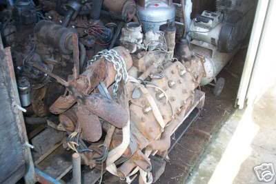

so dizzy on front and intergrated bell housing ?
is this one ?
is this one ?
Same arrangement, but that is a 21 stud engine, so 3 1/16 bore (3.0625!!) or 221ci. (and it looks like a car 3 speed gearbox on the back)

Well i looked at the motors today , the guy i visited has at least a dozen or more 24 stud sidevalve V8`s in his shed . I looked at the 21 stud motor in the picture and decided against it as i want to restore the F15 to close to original . he also had a 24 Stud motor with all the accesories including original linkages that came out of a F15 but he wants $750 for the motor as is . I turned the motor over a few times and it has some compression but not a lot . Is the motor worth getting for $750 or should i haggle the price down a bit ?
