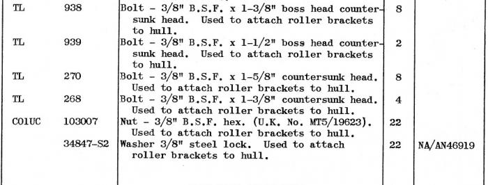

Can anyone tell me what the correct bolt dia/lengths are for the floating axles cast brackets that mount to the hull ? It's the ones with the rollers in that the axle floats on ? All mine were rotted and I have miss placed the two good ones that I did have. ?

Richard, If you mean the cross tube roller brackets, where they bolt to the hull, then they are all 3/8" BSF of various lengths.
They are all countersunk (obvious) heads. The bottom ones that go through the seal retainers, are flat head, and the upper ones are round (boss)head.
They vary in length. the longer ones about 1 5/8". There is a longer one on the left side for the battery earth strap.

Yeah, those are the bolts I mean matey

Just for you Richie. You would use three TL 269, and one TL 270. At the end of the day the count is still twenty-two, but be aware of the countersunk only vs boss head countersunk, aka round head countersunk.
Cross tube roller bracket bolts p.jpg   Richard steering and brake control.jpg

Cheers Ross, that helps a great deal.
Cheers for the quick replies guys

You'll be lucky........Boss heads are not a bolt you can buy off the shelf. You may have to improvise.

Yes just got back... Went countersunk high tensile. Boss heads were a "good luck with that" I could get them in mild but not countersunk which is no use.

I had a few boss head bolts made ages ago. I did ask on here but nobody seemed interested in getting a bigger batch done. I could do with a few of the 5/16 size ones.
I've got drawings for them somewhere.
