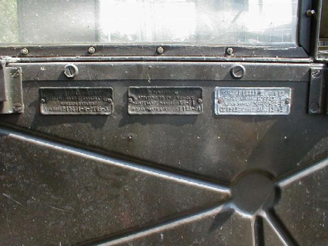

- where are data plates on this truck ??
The data plates on a Ford should be on the inside of the right hand door (this is mine):
Hope this helps,
