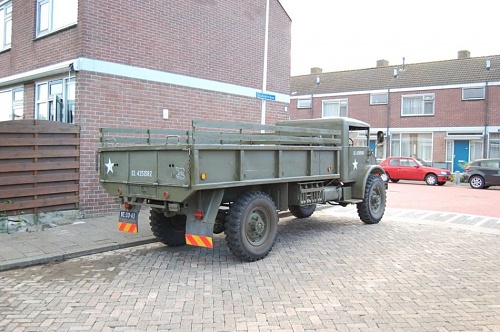

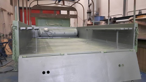

New pics of F60L with what looks like an ex-GMC CCKW-352/353 body:

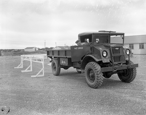

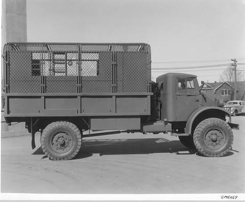

Here is a NZ Army truck with a similar type of rear body:
ID:	124464 Click image for larger version
https://fotoweb.airforcemuseum.co.nz...F3074.jpg.info | https://fotoweb.airforcemuseum.co.nz...Fq%3Dchevrolet

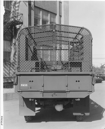

I think Andy was saying his had the rear body of a 352
Dudley

Hanno,
I was told the Dutch F60L was an ex-Stores truck with the wheel-wells cut out and patched. I have seen the truck in person and indeed it does show some welding and does seem to match up with a Canadian body that was seen on late Cab12's and early Cab 13's. (similar body also used for Battery charging truck).
The NZ one does seem to have an ex US GMC 353 body fitted....and even retains the cutout for the GMC fuel tank in the right front.

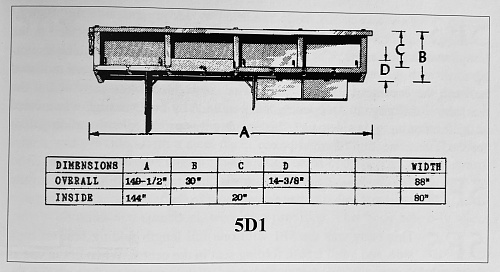

Default 5D1 body
Thanks Alex for sharing your findings.
I have not seen the truck in the metal and before I first shared that picture in 2009 Clive Law hadn’t published his book “Drive to Victory”.
The 5D series body types with 20” high sides certainly seem to be a match, although I wonder why the external part of the wheel wells were removed on this truck.
Hanno, The only reason I can think of, is that someone removed the wheelwells to create a flat loading floor, which seems to be a common post-war mod. But, I agree, that he could have left the external part of the wheels well, which seems a bit "suspicious". I will see if I can dig out my pictures of the truck to support my claim.

It took me a while to dig out my pictures....as usual it was a lot longer ago than I remembered. It must have been 2002 at a veterans day in Ridderkerk, where I worked at the time.
You can see the welded in wheel wells, which to me confirms that it is indeed an original Canadian body. I hope one day the owner will restore the wheelwells, and maybe bring back part of the interior.

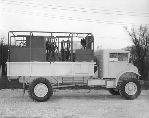

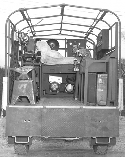

As mentioned earlier, someone once told me it was an ex-Stores truck, but I actually think it might have been a Workshop truck originally.....as it has the panel/cover on the right hand side, near the front of the body (for battery charging?)....and the steps on the tailgate are further apart on a woskhop truck when compared with the stores body.
Attached are some pictures of Clive's Factory photo's CD. Cab12 Stores and Cab 13 Workshop.
Name:	8443 Stores lorry 12 cab 112-2441.jpg
ID:	124546 Click image for larger version
Name:	8443 Stores lorry 12 cab 113-2441.jpg
Name:	8443 Workshop 985-15543.jpg
ID:	124548 Click image for larger version
Name:	8443 Workshop 987-15543.jpg

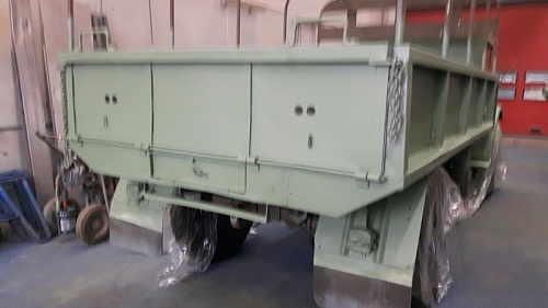

Old 10-09-21, 17:14
Posts: 14,965
Note: this truck is for sale - see http://www.mapleleafup.net/forums/sh...ad.php?t=32774
ID:	124596 Click image for larger version

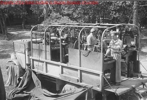

Posts: 14,965
Polish 2nd Corps, workshop units (coll.: Sikorski Institute. London)

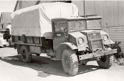

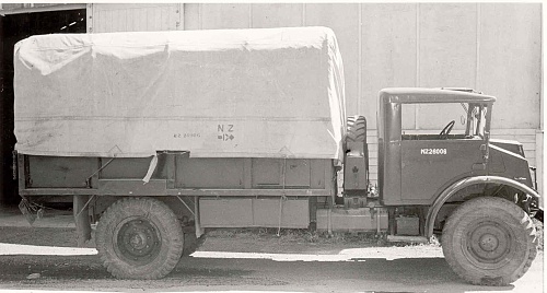

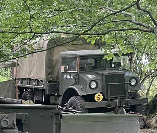

Default One in New Zealand
Ford F60L NZ26006
