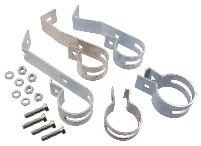

Another option for tailpipe brackets would be to bolt a replacement clamp onto the appropriate length strap. It wouldn't be perfect but it would pretty close and would save a lot of fabrication work. This mob appears to have the correct clamp (bottom left of top pic):
http://www.cgfordparts.com/wwwsectio...LAMPS/HARDWARE
Also Mac's have a bracket with the correct clamp:
http://macsautoparts.com/early-ford-...R3CHL1141416E/
Evidently there are brackets available too:
http://www.ebay.com/itm/1948-1952-Fo...p2047675.l2557
Keith, your clamp is pretty close but the "correct" one is asymmetrical.

Looks like the brackets are more easily sourced than expected.
Yes, after searching the net I don't think they're worth fabricating, so there's probably not much point making drawings - which is good news for Jacques!
Closest I've found is this $30 kit which contains 3 brackets, all of which could be used with minimal modification and be undetectable as non-original:
http://www.parts123.com/parts123/yb....Z5Z5Z50000019A
Mac's have the same kit:
http://macsautoparts.com/ford-pickup...0R3CHL1143645/
Jacques, I imagine these brand new brackets may change your plans a bit so I'll leave the old rusty ones where they are for the moment!
Hi Tony,
Thanks for your information. I did buy a Dennis Carpenter exhaust bracket set a while back but there was not enough length on the longest one to make the bracket that attaches to the fuel tank bracket as shown in the photo.
Yes, thought about the adding a length of flat bar to an existing clamp in the set but forgot about the asymmetrical design too. Good spotting. The set did give up a good old design 2" muffler clamp when I wiggled the poorly spot welded clip attached to it shown in the centre of the photo. Thank God for Dennis Carpenter's poor Chinese made stuff. Saved drilling out a spot weld!
Will check out the supplier mentioned.
When you get a chance Tony would you be kind enough to give me the dimension between the centre of the bolt hole on the clamp to the centre of the first hole where it attaches to the fuel tank bracket then I can work out the length and see if their bracket will do the job. Many thanks again for all your help and a great afternoon with the trucks.

Hi Jacques,
Attached pics show rear tailpipe bracket dimensions as measured in situ, I'll need to remove and straighten it for complete accuracy. I'm pretty sure your Dennis Carpenter bracket will reach the first hole in the petrol tank bracket, and the hole for the rubber mount may be conveniently close to the correct location. Clearly it will need to be extended to reach the second hole, which means butt welding a piece of 1 1/4" strap to the end. The support strap will prevent any flexing at the join so it shouldn't fail. They could even be spot welded together for complete confidence.
The front tailpipe bracket is the offset clamp type, of which there are 3 in the Mac's 48-52 Pickup set. These are considerably longer and will reach the chassis rail, but will still need to be extended to bolt in the original hole. This would have to be an overlap join as there's no support strap, however it would be inside the chassis rail where it wouldn't be seen.
I think that's the solution for tailpipe brackets, clearly it's not worth trying to fabricate new ones when these items from Mac's can be easily modified. The required kits are:
Ford CMP front tailpipe bracket (48-52 Pickup set): http://macsautoparts.com/ford-pickup...0R3CHL1143645/
Ford CMP rear tailpipe bracket (35-38 Pickup set): http://macsautoparts.com/early-ford-...R3CHL1141416E/
I've ordered both sets and will test these mods when they arrive and post results here for general info.
Of course, the 48-52 Pickup set will serve for both brackets, the only difference being the offset clamp on the rear, which is hardly likely to be noticed. After all, we didn't even know there were two types until today!
Hi Tony,
Again, thanks for you great help and good suggestions. In the interim I will go using one of my Dennis Carpenter brackets welded to a flat strip to make the tailpipe bracket that attaches to the fuel tank bracket. It will look reasonable and position it in the right location anyway thanks also to the dimensions you supplied.
May scratch build that bracket later when I get the urge to do a bit of metal working. Should be relatively easy as the original brackets are made of lighter gauge steel than the Dennis Carpenter repro's.
Cheers.
