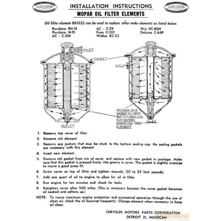

A lot of application info here, it is a UK supplier and good price too.
https://www.inlinefilters.co.uk/Bran...ann/FMH-PF925X
The reason why I order the MANN PF925X is that is comes with a 11 cm diameter rubber ring which fits in the oil filter housing cover nicely.
