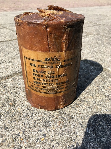

Here is a NOS filter I bought from LWD parts. Other than the first example I had, this one has slight rust from storage (what to expect after 70 years?) so I'll keep it for show.
This is what was listed on the label:
Wix oil filter element
NA/AG 172
Ford C11Q-18663
G.M. 853472
Chysler 923768
Dimensions are (approx.):
Diameter: 96 mm / 3.8 inch
Height: 133 mm / 5.2 inch
Name:	Ford oil filter element.jpg
