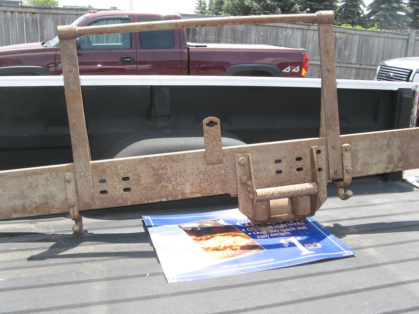

Here is a full photo of the bumper that started this thread.
Old 08-04-17, 17:47
Posts: 7,638
We had one of those exact bumpers still in the crate here at the Shilo museum. It was likely one of the parts from Bill Gregg when he gave his collection to the museum. I installed it on a artillery tractor about a year or two back.

Posts: 281
Thanks Brian! Unfortunately it's a different pattern of holes.
