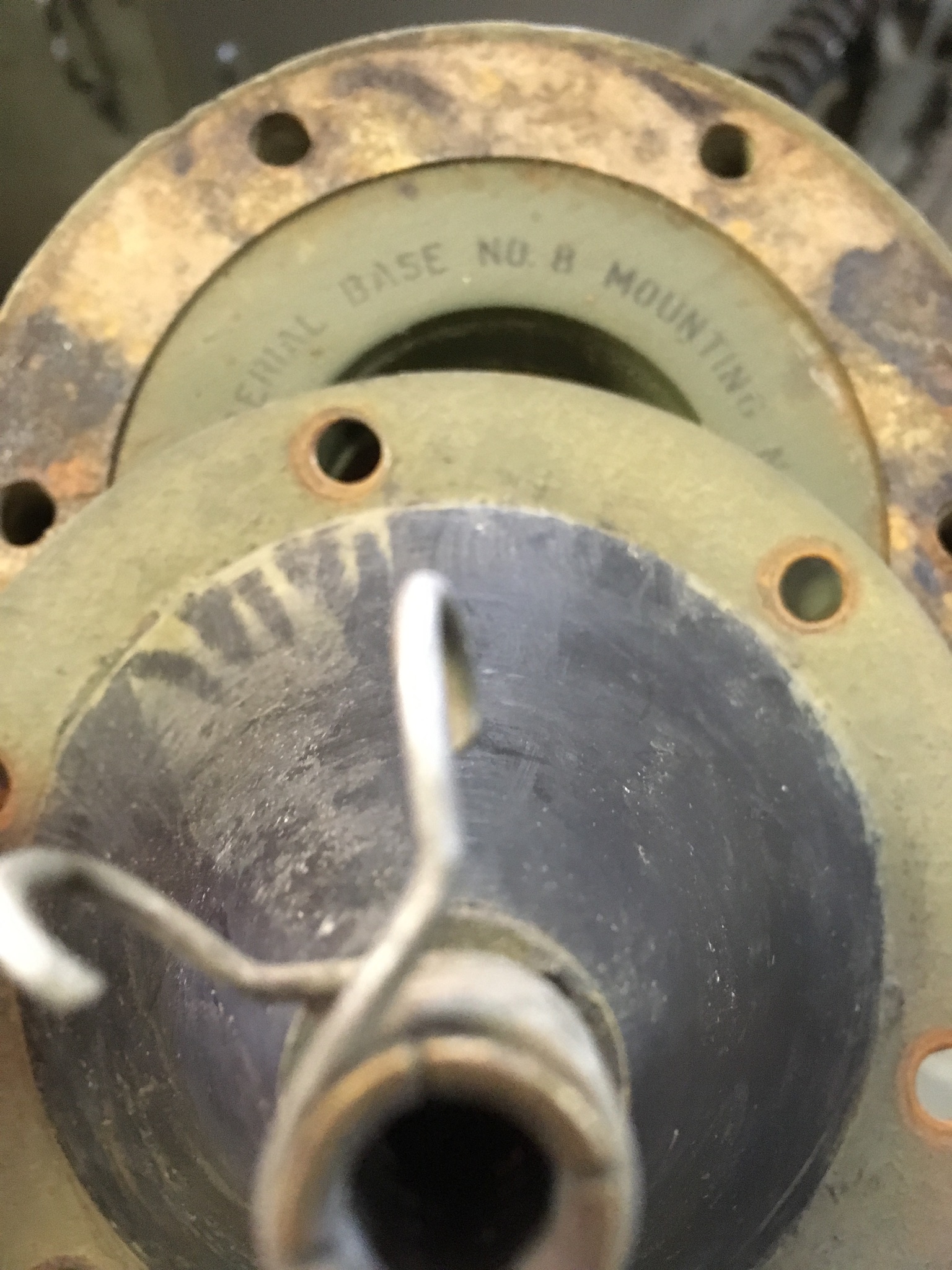

Here i turned the handle around. Nice fit ! Q : were there any markings ie -left - right - on -off ? Is there an OFF ( no fuel position or cutoff ? ) ? .

Try putting the valve in the mid position. I would expect that you would not be able to blow through it through any of the pipe connections. That would tell you where the 'OFF' position is. If there is no off position, the mid position must open the two inlets to each other so allowing the flow of fuel to equalize. I doubt that this would be desirable so I expect that there is an 'OFF' position midway between 'L' and'R'.

Thank you very much David . My valve is at the shop right now but when i get it back i will check the points you are raising . The welder is cutting up , folding and assembling the bracket for the valve . Meanwhile , could someone tell me how to install the radiator overflow can please ? Here are the pictures . I have the standard Ford can from a F-15 truck . I can’t figure out where the brackets should be bolted . Thanks . PS : Still winter here , it snowed today. The deer and wild Turkey are very keen for the corn i leave outside the Carrier shed !

It seems to me that the valves draw from left, both, or right. Running out of fuel half way through the mission and having to prime all over again, or leaving 2 gallons on the bottom of a tank, are not desirable either. Drawing from both simultaneously, if properly vented and the pickup screens aren't blocked, should draw evenly. I am pretty sure it's how a mk1 carrier is plumbed, and I can't fathom why a mk2 would be different.
Old 25-03-19, 03:21
The 3 position valves are: left-both-right. (or for the other hemishere, right- both-left) As I recall from a manual or hand book, it was frowned upon to use the both position.

Left-both-right or right- both -left depending on the hemisphere. Thanks David , Rob and Lynn. Makes quite a lot of sense . In aviation, they have both systems : 1- Left-both-right -off 2- Left-Right-Off. I have seen and met many pilots running out of gas and have an engine quit and force land with a full tank after forgetting to switch tanks with the second system . Now some planes are very sensitive to weight imbalance in the wing tanks and it makes sense to burn the fuel alternatively from one tank to the other but in a Carrier ? I would leave it on both and measure the tanks with the level stick once a day . Now what about the overflow can ? I know it goes under the crew seat in the rear compartment right behind the gunner’s seat because i read all the posts on the subject. But how is the can bolted down ? Anybody know the answer ? Many thanks . Cheers , Bob
