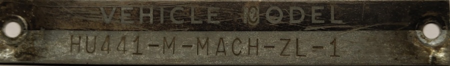

Note: some have a second plate attached to the left of the Vehicle model plate during the conversion to HUM:
The Body plate on rear of body - this plate was added to all C8A Heavy Utilities:
Body Model | Body serial
The Chrysler plate on rear of body - this plate was added during the conversion to HUM:
Chrysler Serial-no
The Number painted on the door:
WD census no.
And Information gleaned from an open source (most often this Forum):
Source
Old 23-08-20, 11:21
Posts: 14,974
Default MACH-ZL Vehicle model plate research
Originally Posted by M.Morren View Post
Just to add to this thread, here are some photos of the data plates of this HUM.
[snip]
I am a bit puzzled about these though. While the Chevrolet plate says that this is a ZL-2, the Chrysler plate next to it clearly says ZL-1. I would love to see what other ZL-2s plates say. Maybe all Chrysler plates are ZL-1 and only the Chevrolet plates got the update?
Also interesting to note: My dash plate also has the C stamped in the upper half. It is stamped right on the 'M' from 'Vehicle Model'.
My observations: the Vehicle model plate is fitted to the left of the ID plate as on all Chevrolets. Two production HUMs have a Vehicle model plate denoting them as "C-8A-MACH-ZL-2", whicle the addtional plate lists "HU441-M-MACH-ZL-1" which is also fitted to (what is thought to be one of) the prototype HUMs. I do not know why they have these conflicting model plates.
See the pictures below:
S/n 3844515289
Vehicle model plate: C.HU-441-M-PERS-1
Additional Vehicle model plate: HU441-M-MACH-ZL-1
Name:	C8A 3844515289 Vehicle model plate.jpg
S/n 3844536670
Vehicle model plate: C-8A-MACH-ZL-2
Additional Vehicle model plate: not present
Name:	C8A sn 3844536670 Vehicle model plate.jpg
S/n 3844536696:
Name:	C8A sn 3844536696 vehilce model plate 1.jpeg
ID:	115717 Click image for larger version
Name:	C8A sn 3844536696 vehilce model plate 2.jpeg
Another HUM I have viewed has the same Vehicle model plates as s/n 3844536696.

S/n 3844536696:
Had the other HUM also a 'C' stamped on the 'M' of the Chrysler plate? 3844515289 and 3844536696 do, and it would be interesting to know if the other ones have this too.
Name:	2020-08-24 22_09_53-Photos.jpg
ID:	115759 Click image for larger version
Name:	2020-08-24 22_10_58-Photos.jpg
Hi Marty,
Can you show me a picture? I am not sure what you mean?
Old 24-08-20, 23:12
I updated the post and added the pictures.

Old 24-08-20, 23:16
Posts: 14,974
I now see what you mean. Looks like the tried to alter "Model" into "Code"?
I'll see if I can see it on the other plate.
Old 24-08-20, 23:18
M.Morren's Avatar
M.Morren M.Morren is offline
Marty Morren
Join Date: Nov 2018
Location: Otterlo, The Netherlands
Posts: 72
That was my guess as well. No idea why that would be necessary, but sure a fun little detail.
