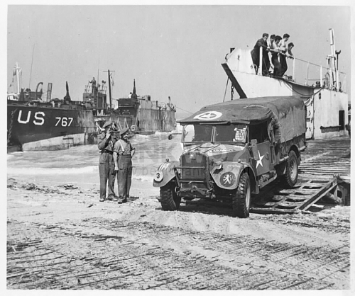

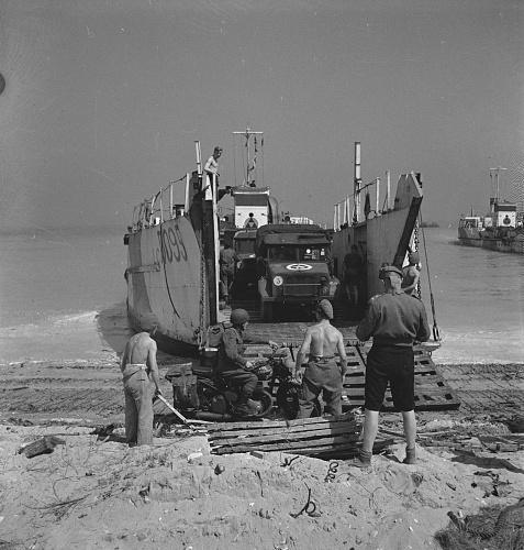

Interesting picture Hanno. That seems to be one of the British 3rd Infantry Division LCT's that landed at Sword beach.
Hi Alex,
If it does show the Prinses Irene Brigade coming ashore, it would mean they had Bedford MW's on strength. As far as I know the Brigade was equipped with Fordson 15-cwt trucks. Do you know if they had Bedford 15-cwt trucks also?
Thanks,
Hanno, I don't know for sure if they had Bedford MW's in service. Some pictures show 15cwt GS trucks from the rear and make if hard to determine if they are Fordsons, Bedfords or even Morris Commercial. Just like you I thought they had Fordson WOT2's (and a WOT3 which is shown on one of the pictures in the national archive). But, they did have Beford QL's as well, so logistically wise, it wouldn't be too strange to have some Bedford MW's on strength. Below is picture from the National Archives, which shows a 15cwt, supposedly from the Irene Brigade......Can anyone ID the truck....maybe the rear axle?

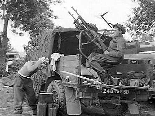

Do I see a split rear axle differential? From this grainy picture I would not wager to ID a vehicle. But the tow hook is the typical British one, leaving Fordson, Morris-Commercial or Bedford to choose from . . .
I´m sure one of the MLU members has a census listing from which one will be able to deduct what type of truck Z4846358 was.
On the TWENOT forum, I read the Dutch were allocated the census number block 1283563 to 1288562. However, these must have been supposed to be allocated to their own vehicles. I´m pretty sure those supplied by the British War Department were meant not to be renumbered.

Going slightly off topic, but interesting pic. Reportedly showing Bedford MW from Prinses Irene Brigade coming ashore in Normandy (via KTR list).
The Nationaal Archief contains the same picture with the same caption:
Beschrijving: Koninklijke Nederlandse Brigade Prinses Irene. Landing in Normandië
Fordson 7V L1284657 was clearly allocated a number from this block (source: www.arnhemsoorlogsmuseum.com)
Just noticed that no one has answered this.
Z4844001 - Z4847000 - Ford - Truck 15cwt 4x2 G/S
Thanks Rich!
Interestingly, the picture shows a Fordson, but the census number range was allocated to Ford trucks

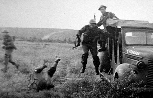

Old 07-04-08, 09:57
Originally Posted by Rogier Peeters View Post
Could this be another of the 15 cwt Ford GS trucks, judging from the (partially visible) census number: http://www.nederlandsfotomuseum.nl/c...elf,1/lang,nl/
If so, it may be this vehicle (note the cyclist and the trailer behind the truck): http://www.nederlandsfotomuseum.nl/c...elf,1/lang,nl/
Rogier,
As pointed out by you and Alex, these pictures feature a Fordson WOT2 15-cwt truck. The first picture shows a Fordson with a census number Z4846x87, one which falls in the range Z4844001 - Z4847000 quoted by Rich. As these were allocated to "Ford - Truck 15cwt 4x2 G/S" trucks, could be the case that the "Ford" and "Fordson" trucks in your list of 15-cwt vehicle types were both Fordson WOT2's?
Here's a better picture of Z4846358 from the new NIOD BeeldbankWO2.nl:
Image number: 8696
Collection: Nederlands Instituut voor Oorlogsdocumentatie
Caption: Dutch forces in Normandy. Air protection is provided by the defense platoon.
The archive document I mentioned before lists Dodge 3 ton trucks as well.
Here's one being (un)loaded. Source: beeldbankwo2.nl:
Image number: 8728
Caption: Dutch forces in Normandy. A Dutch lorry being loaded on to a landing craft.
Image Date Period: augustus 1944
Another PIB vehicle, in this case a Fordson WOT2 coming ashore in Normandy, showing some of the vehicle markings.
Image number: 8746
Caption: Dutch transport coming ashore.
