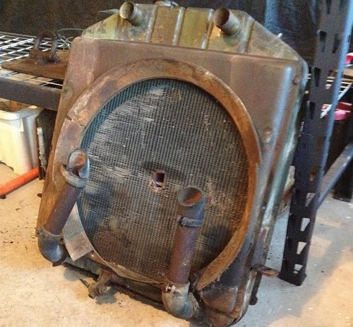

Folks,

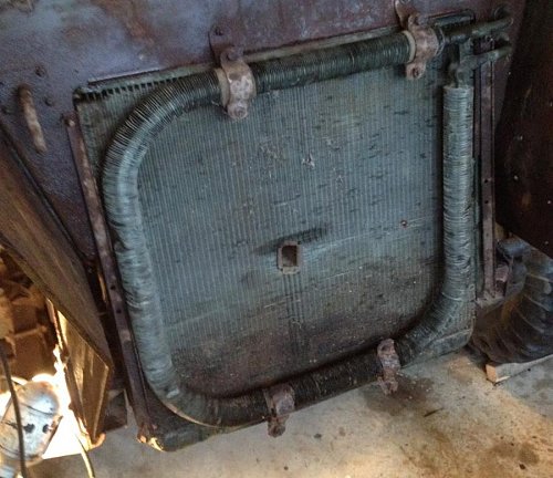

Removed the tail piece today, to expose a strange looking radiator. I can just hear the Ford engineers when they were mocking up the first units. "Need to provide a way to hand crank the engine? Radiator in the way? Just go through it!!"
Name:	2014-04-04 16.03.05 (2).jpg

Old 05-04-14, 03:42
Originally Posted by Peter Duggan View Post
Folks,
Attachment 64757
Attachment 64758
When I had a rad made for my Fox I requested the same 'hole for the crank'. The guy was so iffy (I'll do it but at a price) I gave up. Turns out the core he chose was just short of the real thing so I am able to slide the crank under (rather than through) the rad. All is good!!!
Old 05-04-14, 03:44
chris vickery's Avatar
3RD ECHELON WKSP
Posts: 2,973
Engineering marvel and artwork all in one.
Cool looking rad with the oil cooler. Bet that would be an expensive rebuild. Lets hope for the best.

Old 05-04-14, 03:46
3RD ECHELON WKSP
Posts: 2,973
I did see another rad one time that had the crank hole in the lower rad tank. Might have been my old halftrack, can't remember.

Old 05-04-14, 03:53
Peter,
It is interesting that there is an oil cooler pipe attached to the front of the radiator. Mine does not have that luxury. Here is mine from the back showing the shroud. I presume that yours has that as well. My radiator was in perfect condition but had been removed from the hull in 1958. The local radiator chap only charged me A$125.00 for a full strip down, tube clean and reassemble. It was like a new one inside.

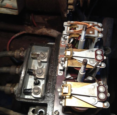

Old 06-04-14, 03:08
Join Date: Apr 2011
Location: Cherry Valley, ON
Posts: 554
Default Wow
Rick,
Same radiator shroud as on yours. I fear the radiator is not the pristine version that you have. One positive surprise is the condition of the interior of the voltage regulator and associated parts. Not bad for 70 year old parts.

Old 06-04-14, 10:23
Rick,
Attachment 64798
Attachment 64799
Peter, your shroud is different to mine. I do not have that 2" flat piece around the opening.
My voltage reg was as good as yours too. Don't forget that the Lynx runs on 12 Volts. Unusual for a Ford during WWII. Actually there are two other voltages as well. 6volts for the gauges and 4.5 volts for the coil.

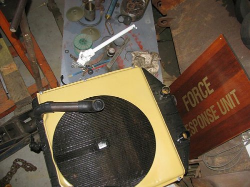

Great pic Michael. Those would be Lynx 1 I think? They all have the armoured type roof.

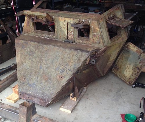

Old 09-04-14, 04:14
Join Date: Apr 2011
Posts: 554
Default Progress
Chris,
Thanks for the good advice. I like to think that I am making slow but steady progress and the pile of restored/NOS and acquired parts is growing. Goal for this year is to dismantle the vehicle and have the frame restored for a sound basis for next year. I'm in it for the long term, but do spend some garage time day dreaming about what it will look like some day.
Peter

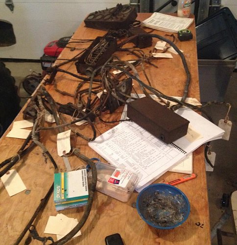

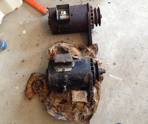

Old 10-04-14, 02:57
Join Date: Apr 2011
Posts: 554
Default Questions and more

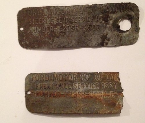

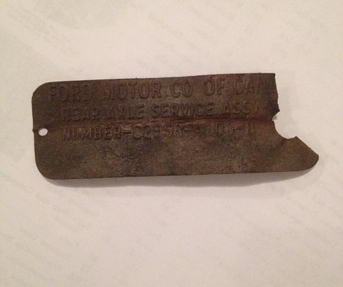

Good day today, removed the engine. Found a tag wired to the rear axle and I've attached a picture. Does this mean the rear assembly was replaced some time during it's career? The speedometer is past resurrection (thanks to Dirk L., I've got a NOS one on the way). But it appears to show over 24,000 miles on the odometer, which for this type of vehicle seems quite high. The oral history I got with the vehicle is that after the Canadian troops left Italy, it was in turn given to the Italian army and ultimately the Italian police, before it was scrapped in the mid seventies. Is there any practical manner of researching the history of a Lynx based solely on the hull number?
Thanks, Peter

Old 10-04-14, 08:43
Join Date: Aug 2012
Posts: 568
Default ID Tag
Hi Peter, I see you making good progress. The tag is the standard diff identification tag. C29SR , I think this means 1942, scout car , rear engined.
The 4000 B is the part number for the diff. In this case 6.66 to 1 ratio.
Has 640 stamped on the back of the housing, which means 6 teeth pinion and 40 crown wheel . Outside dia. of diff housing will be 14 -7/8'' across. This assembly supplied for service from serial #3000.
The front diff will be tagged 3000 C , if the tag is still there. The gen pulley you are going to swap over, just be careful it is not screwed onto the shaft, some are some are just keyed on, a trap for young
players is to put a puller on a screwed on pulley and smash it to bits, I know I have done it!

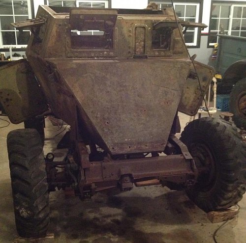

Old 13-04-14, 02:44
Join Date: Apr 2011
Posts: 554
Default Partners
Rick,
You are a lucky man. I've enjoyed 42 years of a great marriage and Marie is quite supportive of my "projects", but in all that time I've never seen her with a tool of any description.
Peter

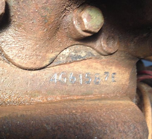

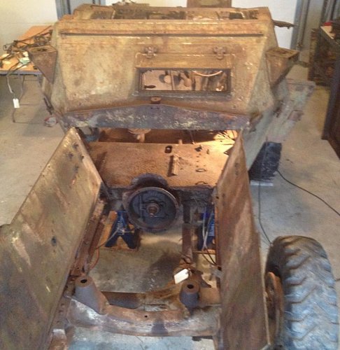

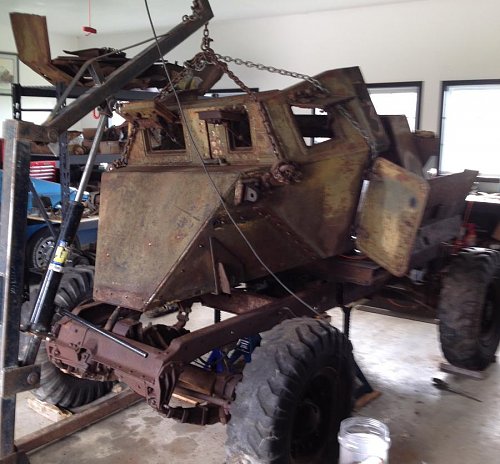

Old 15-04-14, 03:10
Join Date: Apr 2011
Posts: 554
Default Latest
I'm starting to recognize that the most rewarding part of this restoration is the people that you meet and deal with along the way. I had the good fortune (thanks Doug and Rob) to meet Stu Robertson. This gentleman has restored THREE Lynx's, the one that is in the museum in Shilo, Manitoba and two that were exported to collectors in Europe. Not only did he solve my fuel tank quandary, but I walked (staggered) away with a load of NOS parts !! I'm looking forward to the next time that I can meet with Stu and hear more of his CMP stories.

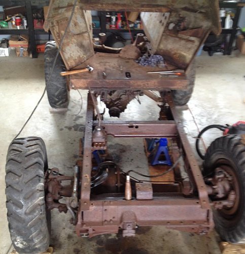

I've attached a picture of the shrinking Lynx and one of the engine block number. Can anyone out there help me decipher the number? I was also able to remove and label all the electrical looms without cutting a single wire.

Andrew,
You were right about the front axle. Here is a picture of the front tag. This exercise is like a treasure hunt.

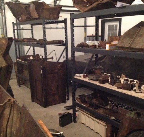

Old 30-04-14, 04:24
Join Date: Apr 2011
Posts: 554
Default Good day

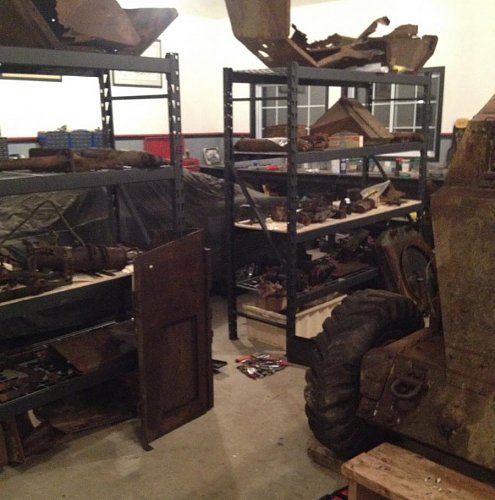

Weather was poor so I got to spend the day in the garage. It's a cruel world. Got most of the crew compartment cleaned out and removed the front nose armour. Very pleased with the overall condition of the mechanical components.
Name:	2014-04-29 21.57.45 (2).jpg
Old 30-04-14, 05:19
Posts: 3,154
I need to echo the advice about plenty of storage totes, and want to add one lesson of my own. Get a stationary supplier's attention and find a hundred or two paper hang tags. Either on strings or wires, when you take something off, put a part name, stock number, condition and source in some form of recognizable shorthand (NOS, TO - Take Off -, used, etc). When I've acquired parts from outsiders, I tend to forget some of the details. With tags, I don't have to remember everything, and I can concentrate on the more important learning.
This is not my slave cable, but it shows a tag that identifies exactly what the piece is.

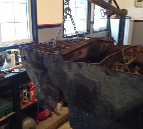

Old 08-05-14, 02:45
Join Date: Apr 2011
Posts: 554
Default Getting there
Another good day in the garage. Spring and yard work is starting to crimp my time in the garage. Made some nice progress and the more of the drivetrain that I expose, the better it looks.
