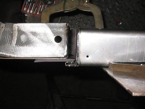

1 - Bob and Grant playing with metal glue on Bob's cab frame.
2 - The frame bound up to let the glue cure.

Well we finally finished the rear wall using that "body shop metal glue". A bit tricky as this was just the second time we used it.
Leave a very smooth finish...... notice total absence of the original CMP manufacturing spot weld.....I know it is too smooth and not original anymore. But the body glue has the advantage of effectively seal the bottom angle iron to the sheet metal which hopefully will prevent the previous rust problem. The stiffening ribs were also glued with the same product instead of the original 3 or 4 sloppy spot weld. It makes for a very tight and solid back wall. Primed with POR 15 and 3 coats of OD 34087 flat.
I used a 1/2 inch x 1/8 thick soft sticky rubber ( do not know what it is called as procured from a flea market) on each side of the floor bolt pattern. All bolted with 5/16 new grade 8 fine thread bolts. The rubber material squished down fine and filled all the irregularities of the dot and dash floor plate. Also used the 1/2 in. cab 12 reinforcements in the rear corner ......all which makes a very stiff rear wall.
Using a carpenter square confirmed that the wall sat at almost a perfect 90 degrees to the floor and frame.
That was for the good news.
Note ..the original unfinished roof was installed to see how things fitted.

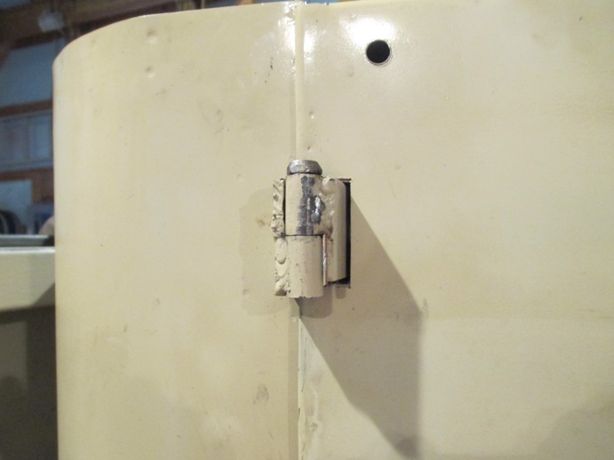

So I decided to try out the original cab 11 door..... now the hinges are all bent out of shape but nonetheless...............
......... most of the gap disappeared....?
The solution is complex and as yet to be fully tested...
First the leading edge of the door...... where the sheet metal skin is folded over is at least twice as wide as all opposite side or the bottom and curved area.
But I am still short of reaching the actual latch mechanism in the front cab frame.
My front latch frame on the arches are also worn and have since been removed fro sandlasting and rebuilding to full size with the welder.
The other observations is that of all the doors that I have NOT one set of hinges has the same twist, deformation and /or butchered welding.
So selecting the best hinges and using the hydraulic press we have reshaped a full set to the same profile which I believe...... fingers crossed..... will actually move the door forward sufficiently to line up properly.
I hope we have the solution and averted further surgery.

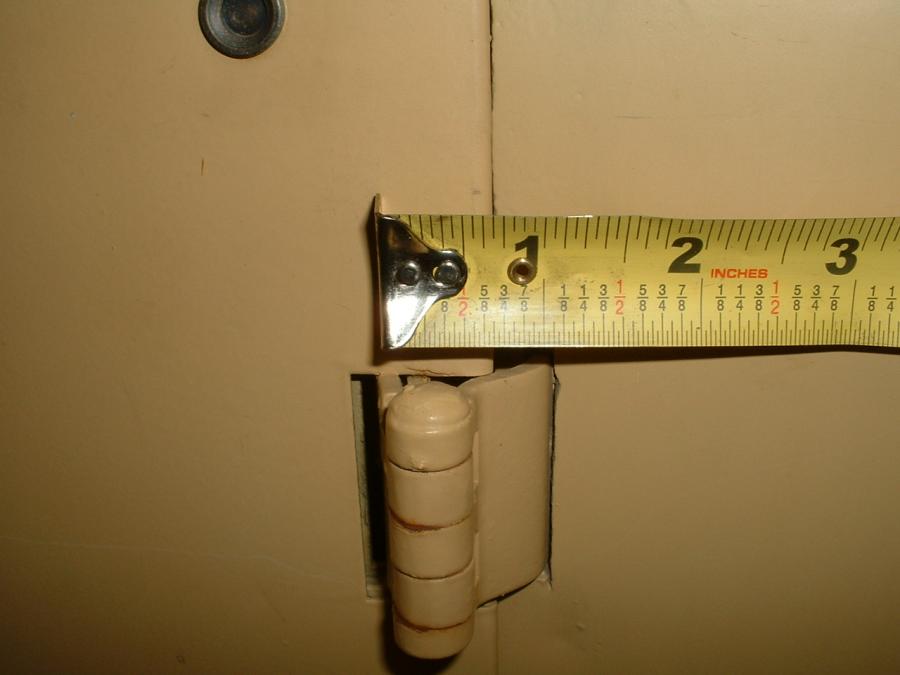

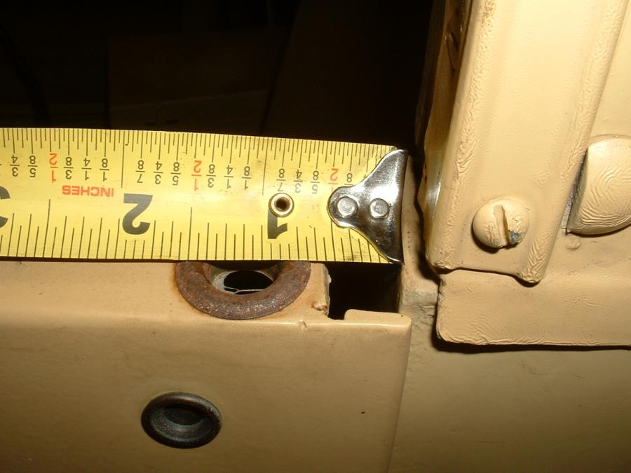

Hi Bob,
Took some photos of the door hinges on my cab 11 C8 today. Both halves of the hinge are bent to give about 7/8" gap between the two pieces. Has a fairly large gap between the cab back panel and the hinged part of the door also...the doors fit and latch well.
Thanks, David

Default Thank you....
For the re assurance.....looking at your hinges I can see that my door hinges, which are flat at the moment, will need some tweaking to get the proper gap at the rear of the door. I also have the luxury of adjusting the door skin, which is not yet installed, to make up some of the space.

Hi Bob,
My truck had no remnants of rubber anywhere around the door openings. Both of the adjustable latch parts on the body were welded in place by someone, so I cleaned the welds up a little and the doors latched properly without modification to the hinges or anything...got lucky there! I did have to install two shims under the front of the rear body panel to make the doors raise at the front and line up right...one thin shim at the rear makes a big difference at the front...
Thanks, David
