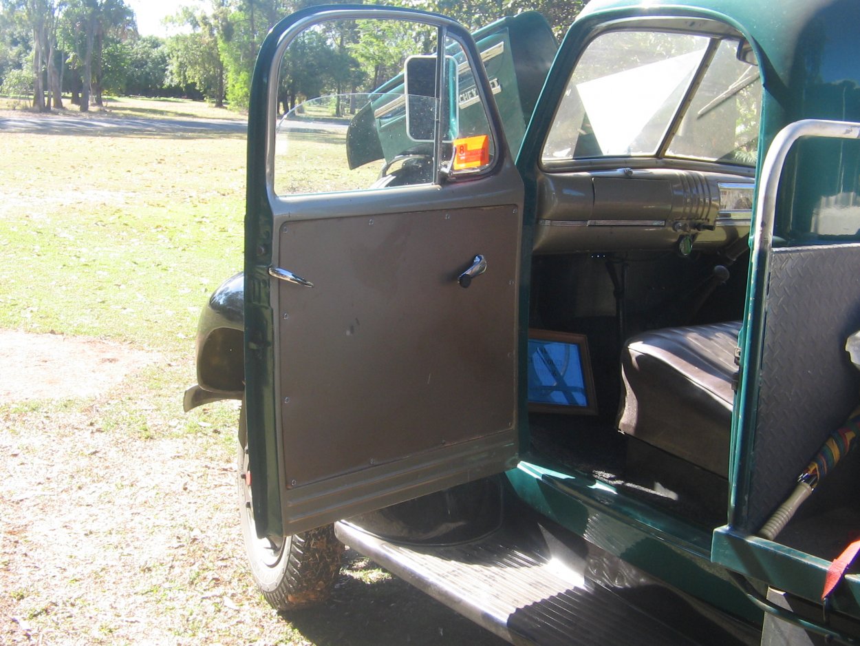

Both my mate and my Chevrolet trucks have the bullet lights and integrated or composite gauges set in a rectangular cluster. Also both mine and Merv's grille both have 16 horizontal bars. I cannot remember which whether the 1939 had one less or one more horizontal bars on the grille. Both trucks are also plated Holden's 1940. The photographs of my truck were taken when I first saw it in Dalby and I was preparing it for a tilt truck ride to its new home.
The previuus owner of my truck installed the external fuel tank. Merv upgraded the 6 volt system from a generator up to a 12 volt system with an alternator. My wiring is stock 6 volt generator. Oh and Merv put a 1950's chrome label "Chevrolet" on his engine hood's side shown in an earlier photograph.
In the Second last - bottom photograph you can look at the extreme right and just see the rectangular gauges cluster. The photo was taken originally to show that Merv's truck had a pretty lining on the door - where mine does not. Whether it had one in the first place and it has since fallen off I am not sure.
The last photograph shows what the blurry image is in the passenger footwell of the second last photo is. It is a display plaque that Merv puts up during truck shows. Merv's father bought the truck new and it is still in the shed on the same sugar cane farm.

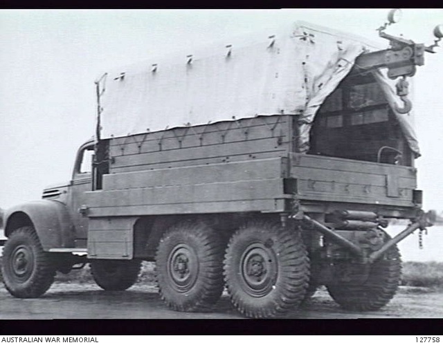

Hello All,
I just found a new photograph that actually shows the rear view of the breakdown cranes
Do they look more like the M.E Breakdown crane pictured in my last message?
What are the two horizontal boards just below the towing hitch?
Would the lights be converted headlights or were they proper flood/spot/work lamps?

Old 24-11-16, 01:44
Lionelgee's Avatar
Lionel G. Evans
Join Date: May 2009
Posts: 746
Hello Allan,
Thank you for the tip about the objects being spreader bars. Is the photograph you are referring to about the Ford's with the spreader bars? Accessed November 24, 2016 from https://www.awm.gov.au/collection/127758
ID number 127758
Collection type Photograph
Object type Black & white
Physical description Black & white
Description AUSTRALIA. LORRIES, 3-TON BREAKDOWN (AUSTRALIAN) NO.3A. FORD. THREE-QUARTER REAR VIEW, LEFT SIDE.
Was the Ford a Marmon-Herrington conversion with tandem axles? Was it then even more modified into a 6 x 6 configuration?
I found a site last night that showed what kit was fitted to and stored in the CMP version of the twin boom Holmes or Gar Wood cranes. It was that extensive that the kit took up more space than the truck itself when it was spread out on the ground as a display. I just realised I did not save the link ...
Kind Regards
Lionel
1935 REO Speed Wagon.

Old 24-11-16, 17:54
Allan Currey's Avatar
Allan Currey Allan Currey is offline
Join Date: Apr 2010
Location: Wollongong, Australia
Posts: 36
Hi Lionel,
Yes, that's one of the pictures. There are several others showing both 4 and 6 wheel, MCP and CMP trucks which you would have found. They all appear to have some sort of those bars fitted.
Allan
