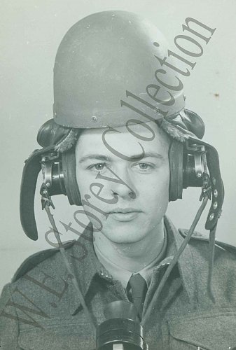

Something out of Dr. Seus?
Attachment 88220
OK, that's cute. So much for my comment about the metal straps on the top making it difficult to wear a helmet!!

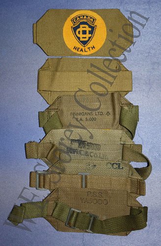

There must have been a lot of surplus web headbands after the war as it seems that quite a few were converted into Canadian Civil Defence armbands. Here are some of my examples.
