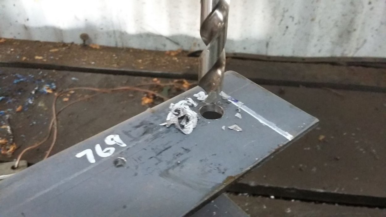

Well I arrived around 10:00 and Ron showed me his 'small' drill press and the smaller version out of picture.
After a quick brief Ron leaped out to his Alvis not to be seen again for some time. I was left to my own devices and after drilling all of the pilot holes I set to task.
The results are just brilliant and I had to check all my lines about five times in disbelief I was making a reproduction part for my truck that was exact. (error by manufacturer and all ).
It look great and thanks Ron for the use of the drill.

I removed the temporary brace and the 1/4" rivet misalignment has become about 1/16" ordered additional rivets but they are too small so I'll have to make up some with steel rod.
Ian

Hi Ian,
Further to previous post:
Just checked my Bible, "Machinery's Handbook" and found American Standard and British Standard dimensions for small solid rivets.
American Standard call them Button Head and my best estimate is they are a 3/8" shank diameter as the shank tolerances are 0.375" to 0.380" Allowing for slight deforming when being driven, that would account for the larger diameter as measured. I can also see a slight taper from under the head to where it was ground off on my sample which indicates a smaller initial diameter.
I measured the diameter of the shop head and at 0.675" I would say it is an American Standard, and not a British Standard rivet. American Standard 3/8” Button Head diameter tolerances 0.646” to 0.684”
Maximum rivet head diameter for a British Standard 3/8" shank Snap Head rivet is 0.656", a fair bit smaller.
I can post all the dimensions on a sketch of the shop head if you would like them.
