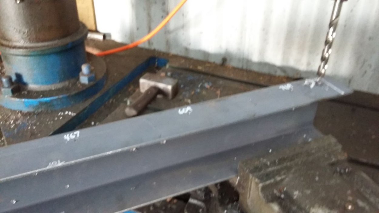

Well I arrived around 10:00 and Ron showed me his 'small' drill press and the smaller version out of picture.
After a quick brief Ron leaped out to his Alvis not to be seen again for some time. I was left to my own devices and after drilling all of the pilot holes I set to task.
The results are just brilliant and I had to check all my lines about five times in disbelief I was making a reproduction part for my truck that was exact. (error by manufacturer and all ).
It look great and thanks Ron for the use of the drill.
