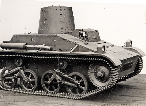

#754
Does anyone recognize this type of light. This is the one that is on the turret of the Vickers and I just can't seem to find any reference as to its brand. I'm sure it would have been a common one of the day (1936) and my turrets just won't look right without the same or at the very least a similar style of light.
Colin. |

The Simms spotlights are still to be found in the UK. They were used on Matilda and armoured cars as well. regards, Richard

Further to Richard's remark, I have seen a square style of searchlight on Vickers light tanks, too. So, and alternative may be the post-war light as currently offered in Tim Vibert, see http://milweb.net/classifieds/view_l...ad=91660&cat=8 That could give you a period looking light, at least until you find a better one? HTH, Hanno Source: http://tankdevelopment.blogspot.nl/

It is a Simms type 6AIB and the original army number was LV6MT3/SS/6AIB you could try Mike Stallwood (RR Services) or Richard Banister Richard
