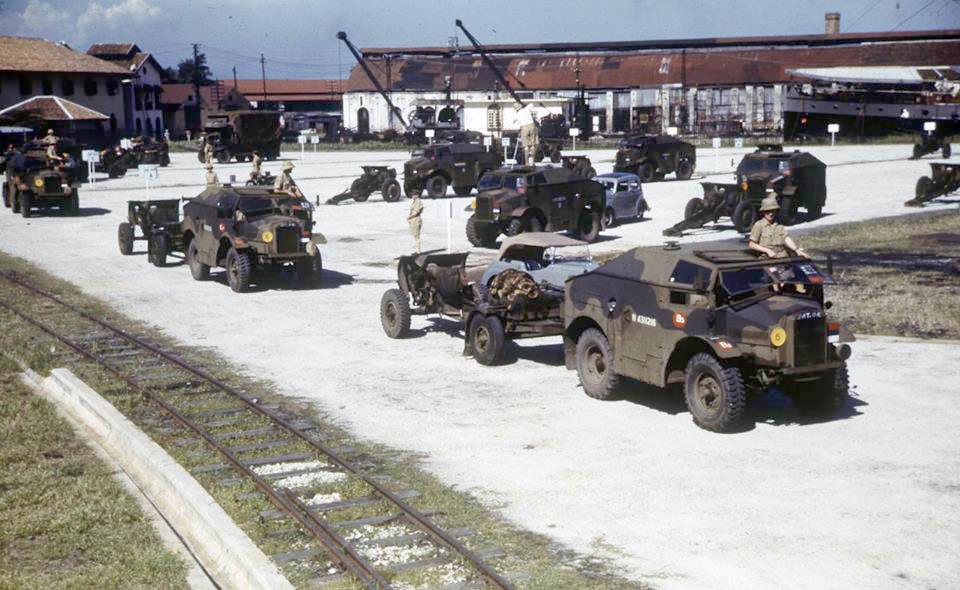

While on this, I have a question.
Here are only 2 pictures of a series captioned "Singapore 1941". Apparently the same place and the same time, to my eye also the tractors, limbers and guns are the same. Why this 2-ton difference in the bridge class then?
