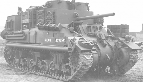

Did the British convert Ram IIs to ARVs? In all, Canada converted 50 Rams to ARVs, in 1943, but 38 were Ram Is (out of the 40 sent to the UK) and 12 Ram IIs.
Roger Lucy

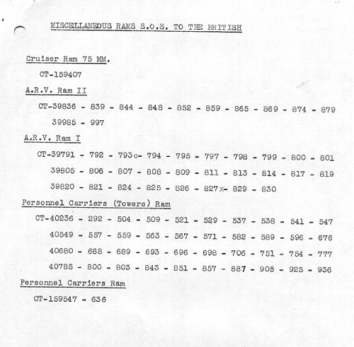

I have attached the document I was referring to in my previous post. I believe Don Dingwall found it sand has passed it on to a few other folks.
You can see that on 28 July 1945 there were 8 Ram I and 2 Ram II ARV's held in Canadian stocks.
The same document shows that 28 Ram I and 12 Ram II ARV's had been previously transferred to the British.
Totals are:
Ram I ARV: qty.36
Ram II ARV: qty.14
Grand total 50
This list shows a total of 40 Mark I tanks but only 36 of these configured as ARV's. 1 is listed as salvage and 3 remain as cruisers. This 1945 document agrees with the Clive's detailed list on RamTank which contains records for 36 Ram Mark I ARV's held in Canadian stocks in January 1944. It gets interesting when you look a the details of the Ram II ARV's in Clives List. There are 15 in total, 14 of these are in Canadian Stocks as of January 1944 but the 15th, which is very definetly a ARV Mark II with Winch, (CT-159854) has the following entry:
"Jan 1944, shown as Struck Off Strength to the British delivered to 13 AFV Depot, Kegworth
Oct 1944, shown as Struck off Strength to British
KT, date unknown, shown as a Cruiser held by C Sqdn, 12 CAR (TRR) and named "Canadian"
KT, date unknown, shown as an ARV held by 12 CAR (TRR) and named "Canadian" "
Correct, and I shared it with the forum members in 2007:
the official Ram tank holding listings only mention Gun Towers, Ammunition Carriers, Personnel Carriers and Wasp equipped turretless Rams.
Follow the link to see scans of the entire listings.
2)

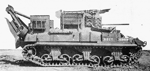

I guess the question is were the Canadian ARV numbers based on the platform used for the conversion or the model of ARV created? It appears that 36 Ram Mark I cruisers were converted to ARV Mark I configuration and 14 Ram Mark II cruisers were converted to ARV Mark I configuration.
The answer is that the Mk.'s designated the type of ARV, not the type of gun tank it was converted from.
So the ARV I was the basic recovery vehicle, indeed the Ram ARV I was an exception as all the other ARV I's shedded their turret.
The ARV II (see attached pics) was the proper recovery vehicle with a winch and a fixed, heavily armoured superstructure added.
Either type or ARV could be converted from either type of gun tank. It is important to differentiate between the gun types and the manufacturing details. Often features like the early suspension bogies with the centre top roller, hull side doors, auxiliary machine-gun turret etc, are associated with the Ram Mk.I. Untrue, the Ram Mk.I was fitted with a 2-pdr gun, while the Mk.II was fitted with a 6-pdr. gun. Must remind myself to send Clive that list of Ram manufacturing changes for inclusion on his website, as they clearly show those changes were much more gradual than the change from 2- to 6-pdr gun which led to the change in designation.
Hope this helps,

This is very interesting and useful.The file at LAC on Recovery Tanks has weekly returns on which tanks were sent to Wingets for modification, which ones were still there and which ones had been delivered. It's out for copying right now but when it's back I can retrieve it and determine how many Ram Is were in fact converted.
The work to modify the Rams as ARVs began in May, 1943 and was to be completed at the end of July, however due to a shortage of many of the required parts and tools,the last converted Rams were not delivered until February 1944, by which time Canadian Armoured units were being equipped with Sherman III and Sherman V ARVs. The original intent was to convert 78 Rams including all 40 Ram Is, the remainder being made up by early Ram IIs with the sponson doors. With the change of policy to equip armoured regiments with Sherman ARVs, Wingets was advised on 16 July to cease conversions after the 50th tank. i.e 38 Ram Is (of the other two, one was listed as derelict and the other had been earmarked for conversion as an AVRE) and 12 Ram IIs.
The vehicles were delivered to Wingets stripped of their armament and traverse mechanism and all equipment. Modifications at Wingets comprised removing the turret basket, and installing: bronze plates to secure the turret, a mantlet plug and dummy armament, stowage bins on the hull rear to hold spare parts, a dismountable jib with stowage brackets, a winch, a cable reel, a rear towing attachment and a Hollybone-drawbar. They were based on a Grant from the REME AFV Experimnetal Wing at Arborfield whose ability to haul a Ram through a muddy field were successfully demonstrated to 4 and 5 CAD in October 1942. In December 5 CAD had Grant T24594, converted along the same lines. Originally CMHQ planned to covert Grants into ARVs but in March 1943, it was decided to use early Rams instead.
The Ram ARV II CT159854 in the photo (and its also in Clive's register) is very late production and Clive's register shows it being transferred to the British in January 1944. Is it possible it was converted under British auspices, not Canadian, in which case all Canadian conversions were to ARV I configuration?
Roger Lucy

Default Ct/t-159854
Good Morning to all....
Some infor ref 159854
CT. 159854/REC 159854 - Ram IID & ARV
13 Tp, C Sqn, 12th (Canadian) Armoured Regiment (Three Rivers Regiment), Central Canadian Stocks & Central British Stocks
'COBAULT' while a gun tk with 12 CAR
- Mar 43 - Worthing, UK. Veh with 12 CAR. Internet pic via 'Armoured Acorn' -
- Veh later converted to ARV - Pic 'REC2 - 04' via Paul Roberts Archive
- 1944/45 - Veh struck off strength Canadian Central Stocks to British Stocks - Canadian Archives
Hope this is of interest
Roddy

Default RAM ARVs (Long Post)
To all -
Following on fm above, I have the fol details of the 50 RAM ARVs:
CT. 39791 - TKC 13 - Ram I (converted to Ram ARV) - Contract CDLV 283
A Sqn, 6th (Canadian) Armoured Regiment, 27th (Canadian) Armoured Regiment (Sherbrooke Fusiliers Regiment), Central Canadian Stocks & Central British Stocks
Montreal Shop No - 7
- 1 Jun 42 - UK. Veh into Regt wksps for 100 hr inspection
- 8 Oct 42 - Veh to wksps for 400 hr inspection - Regt Daily Veh Reports - RG24-C3, Vol 14212, ps. 653 & 1510
- 4 May 43 - Aldershot, UK. Veh fm 27 CAR to 1 CBOD - 27 CAR War Diary, Can NA Microfilm, T-12756, p.884
- 8 May 43 - UK. Veh to Winget Ltd for convertion to Ram ARV
- 4 Sep 43 - Veh convertion complete - Can GHQ Tank Files, T-17893
CT. 39792 - TKC 9 Ram I (converted to Ram ARV) - Contract CDLV 283
Montreal Shop No - 5
- 5 Aug 43 - UK. Veh arrived at Winget Ltd & awaiting conversion to Ram ARV
- 2 Oct 43 - Veh undergoing conversion
- 23 Oct 43 - Veh noted as shipped by Winget Ltd - Can GHQ Tank Files, T-17893
CT. 39793 - TKC 8 Ram I (converted to Ram ARV) - Contract CDLV 283
AFV Gunnery School, Lulworth, Central Canadian Stocks & Central British Stocks
Montreal Shop No - 10
- Apr 42 - Lulworth, UK. Veh noted with Gnry School - www.ramtank.ca
- 24 Sep 43 - UK. Veh arrived at Winget Ltd & awaiting conversion to Ram ARV - Can GHQ Tank Files, T-17893
CT. 39794 - TKC 7 Ram I (converted to Ram ARV) - Contract CDLV 283
9th (Canadian) Armoured Regiment (British Columbia Dragoons), 4th (Canadian) Ordnance Sub-depot, Central Canadian Stocks & Central British Stocks
Montreal Shop No - 15
- Aug 42 - Veh noted with 9 CAR
- Sep 42 - Veh sent on to J Olding for modification
- Oct 42 - Veh to 4 Can Ord Sub-depot - www.ramtank.ca
- 27 May 43 - UK. Veh arrived at Winget Ltd & awaiting conversion to Ram ARV - Can GHQ Tank Files, T-17893 - 1944/45
CT. 39795 - TKC 9 Ram I (converted to Ram ARV) - Contract CDLV 283
RHQ Tp, HQ Sqn, 10th (Canadian) Armoured Regiment (Fort Garry Horse)
Montreal Shop No - 16 Ram I with FGH
- 9 Aug 42 - UK. Veh loaned to A Sqn. Noted on Sqn Movement Orders - Regt War Diary, Can NA Microfilm T-12695/001468
- 9 Aug 43 - UK. Veh arrived at Winget Ltd & awaiting conversion to Ram ARV - 16 Oct 43 - Veh undergoing conversion
- 23 Oct 43 - Veh converted and awaiting shipment to units - Can GHQ Tank Files, T-17893
CT. 39797 - TKC 14 - Ram I (converted to Ram ARV) - Contract CDLV 283
A Sqn, 2nd (Canadian) Armoured Regiment (Lord Strathcona's Horse), Central Canadian Stocks & Central British Stocks
Montreal Shop No - 18
- 21 Apr 42 - UK. Veh issued to LdSH
- 31 Jul 42 - UK. Veh noted in LdSH veh nominal roll - Regt War Diary, Can NA, Microfilm T-12564
- 22 Aug 42 - Veh evaced to Bde Ord Wksp
- 2 Sep 42 - Veh further evaced to Base Ord Wksp - Regt War Diary, PRO WO179/1148
CT. 39798 - TKC 15 - Ram I (converted to Ram ARV) - Contract CDLV 283
B Sqn, 6th (Canadian) Armoured Regiment (1st Hussars) (ARV part of Central Canadian Stocks & Central British Stocks)
Montreal Shop No - 19
- 9 May 42 - UK. Veh motor under wksp observation - Regt Daily Veh Report - CAN RG24-C3, Vol 14211, p.534
- 1944/45 - ARV struck off strength Canadian Central Stocks to British Stocks - Canadian Archives
CT. 39799 - TKC 16 - Ram I (converted to Ram ARV) - Contract CDLV 283
C Sqn, 6th (Canadian) Armoured Regiment (1st Hussars), C Sqn, 27th (Canadian) Armoured Regiment (Sherbrooke Fusiliers Regiment), Central Canadian Stocks & Central British Stocks
Montreal Shop No - 20 - Was both Gun Tk & Ram ARV with 27 CAR
- 3 Jun 42 - UK. Veh with 6 CAR & into wksps for new clutch
- 10 Jun 42 - Veh back into wksps for damaged Homelite engine
- 8 Oct 42 - Veh to wksps for 400 hr inspection - 6 CAR Daily Veh Reports - CAN RG24-C3 Vol 14212, ps.656, 662 & 1510
- 4 May 43 - Aldershot, UK. Veh fm 27 CAR to 1 CBOD (prob for conversion to ARV) - 27 CAR War Diary, Can NA Microfilm, T-12756, p.884
- 4 Sep 43 - Veh convertion complete - 11 Sep 43 - Veh converted and shiped out fm Winget Ltd - Can GHQ Tank Files, T-17893
- 9 Jan 44 - UK, Ex FROST. Veh noted back with 27 CAR as ARV. Was X cas during ex with carburettor probs - 27 CAR ex veh returns, Regt War Diary, Can NA Microfilm T-12757
- 1 Apr 44 - Veh as ARV noted with C Sqn, 27 CAR - Regt op veh listing, Regt War Diary, CNA Microfilm T-12757, ps.1734-1740
- 1944/45 - ARV Veh struck off strength Canadian Central Stocks to British Stocks - Canadian Archives
CT. 39800 - TKC 18 - Ram I (converted to Ram ARV) - Contract CDLV 283
Montreal Shop No - 21
- Apr 42 - Lulworth, UK. Veh to Gunnery School, Lulworth - www.ramtank.ca
CT. 39801 - TKC 21 - Ram I (converted to Ram ARV) - Contract CDLV 283
Montreal Shop No - 22
- 4 Sep 43 - Veh in conversion to Ram ARV with Winget Ltd
- 10 Sep 43 - Veh noted as converted and awaiting shipment out to units
- 2 Oct 43 - Veh noted as shipped out fm Winget Ltd - Can GHQ Tank Files, T-17893
CT. 39803 - TKC 24 - Ram I (converted to Ram ARV) - Contract CDLV 283
2nd (Canadian) Armoured Regiment (Lord Strathcona's Horse) & Held against Central Canadian Stocks
Montreal Shop No - 24
- 14 Apr 42 - UK. Veh issued to LdSH
- 18 Oct 42 - Veh noted as in Ord Wksps - Regt War Diary, Can NA, Microfilm T-12564
- 5 Jun 43 - UK. Veh arrived at Winget Ltd & awaiting conversion to Ram ARV
- 9 Oct 43 - Veh undergoing conversion
- 15 Jun 45 - Veh listed as held on stock against Canadian census charge - Canadian Archives
CT. 39804 - TKC 25 - Ram I (converted to Ram ARV) - Contract CDLV 283
C & B Sqns, 6th (Canadian) Armoured Regiment (1st Hussars) & ARV held against Central Canadian Stocks
Montreal Shop No - 25
- 18 May 42 - UK. Sqn enquiry ref damage to veh armament - 1 H Regt Orders
- 28 May 42 - Veh undergoing 100 hr Inspection
- 1 Jun 42 - Veh into wksps for Fire Extinguisher refit
- 8 Oct 42 - Veh to wksps for 400 hr inspection - Regt Daily Veh Reports - CNA RG24-C3 Vol 14211, ps.419 & 556, Vol 14212, p.653 & 1510
- 8 May 43 - UK. Veh to Winget Ltd for conversion to Ram ARV
- 15 Jun 45 - ARV listed as held on stock against Canadian census charge - Canadian Archives
CT. 39805 - TKC 4 Ram I (converted to Ram ARV) - Contract CDLV 283
Montreal Shop No - 26
- 21 Apr 04 - UK. Veh issued to LdSH
- 31 Jul 42 - UK. Veh noted in regt veh nominal roll - Regt War Diary, Can NA, Microfilm T-12564
- 2 Sep 42 - Veh evaced fm regt to Base Ord Wksp - Regt War Diary, PRO WO179/1148
CT. 39806 - TKC 17 - Ram I (converted to Ram ARV) - Contract CDLV 283
Montreal Shop No - 27
- 8 Apr 42 - UK. Veh issued to LdSH
- 2 Oct 43 - Veh noted as having been shipped out of Winget Ltd - Can GHQ Tank Files, T-17893
CT. 39807 - TKC 27 - Ram I (converted to Ram ARV) - Contract CDLV 283
B Sqn, 5th (Canadian) Armoured Regiment (8th Princess Louise's New Brunswick Hussars) & 4th (Canadian) Ordnance Sub-depot
Montreal Shop No - 28
- Aug 42 - Veh TOS 5 CAR
- Sep 42 - Veh to J Olding for modifications - www.ramtank.ca
- 7 Dec 42 - UK. Veh back to 5 CAR fm Depot - Regt War Diary, Can NA Microfilm T-12651
- 29 May 43 - UK. Veh arrived at Winget Ltd & awaiting conversion to Ram ARV
CT. 39808 - TKC 2 Ram I (converted to Ram ARV) - Contract CDLV 283
Montreal Shop No - 29
- 10 Sep 43 - Veh noted being converted
- 2 Oct 43 - Veh noted as converted & awaiting shipment - Can GHQ Tank Files, T-17893
- Oct 44 - Veh noted as ARV with Hays Plant Ltd - www.ramtank.ca
CT. 39809 - TKC 6 Ram I (converted to Ram ARV) - Contract CDLV 283
Montreal Shop No - 30
- 6 Aug 43 - UK. Veh arrived at Winget Ltd & awaiting conversion to Ram ARV
CT. 39810 - TKC 30 - Ram I (converted to Ram ARV) - Contract CDLV 283
9th (Canadian) Armoured Regiment (British Columbia Dragoons) & Held against Central Canadian Stocks
Montreal Shop No - 31
- Aug 42 - UK. Veh noted with 9 CAR
- 23 Oct 43 - Veh undergoing conversion - Can GHQ Tank Files, T-17893
CT. 39811 - TKC 40 - Ram I (converted to Ram ARV) - Contract CDLV 283
A Sqn, 6th (Canadian) Armoured Regiment (ARV with Central Canadian Stocks & Central British Stocks)
- 8 May 42 - UK. Veh engine burnt out with 1H. Veh in Regt Wksps awaiting new engine
- 8 Oct 42 - Veh to wksps for 400 hr inspection - Regt Daily Veh Reports, CAN RG24-C3, Vol 14211, p. 533 & Vol 14212, p. 1510
- 5 Aug 43 - UK. Veh arrived at Winget Ltd & awaiting conversion to Ram ARV - Can GHQ Tank Files, T-17893
CT. 39813 TKC 1 Ram I (converted to Ram ARV) Contract CDLV 283
Montreal Shop No - 33
CT. 39814 TKC 10 Ram I (converted to Ram ARV) Contract CDLV 283
B Sqn, 10th (Canadian) Armoured Regiment (Fort Garry Horse)
Montreal Shop No - 34
- Veh Ram I with FGH
- 9 Aug 42 - UK. Veh loaned to A Sqn for exercise - Sqn Movement Order, Regt War Diary, Can NA Microfilm T-12695/001468
CT. 39815 TKC 11 Ram I (converted to Ram ARV) Contract CDLV 283
A Sqn, 10th (Canadian) Armoured Regiment (Fort Garry Horse)
Montreal Shop No - 35
CT. 39816 TKC 37 Ram I (converted to Ram ARV) Contract CDLV 283 & (ARV) 2539
C Sqn, 5th & 2nd (Canadian) Armoured Regiments (8th Princess Louise's New Brunswick Hussars & Lord Strathcona's Horse)
Montreal Shop No - 36
- Veh Turret No with 5 CAR - 'C22'
- Aug 42 - UK. Veh TOS 5 CAR
- Sep 42 - Veh with 5 CAR. Noted as in wksps for repair
- 7 Dec 42 - Veh back to 5 CAR fm wksps - 5 CAR Regt War Diary, Can NA Microfilm T-12651/000621 & 000867
- 27 Apr 43 - UK. Veh fm Winget Ltd after conversion to Ram ARV - Can GHQ Tank Files, T-17893
- 18 May 43 - Veh TOS as ARV fm 5 Cdn Armd Div Wksps - LdSH War Diary, PRO WO179/1882
- Prob went on to become pilot veh for Ram ARV Mk.I - 'Wheels & Tracks', No.51

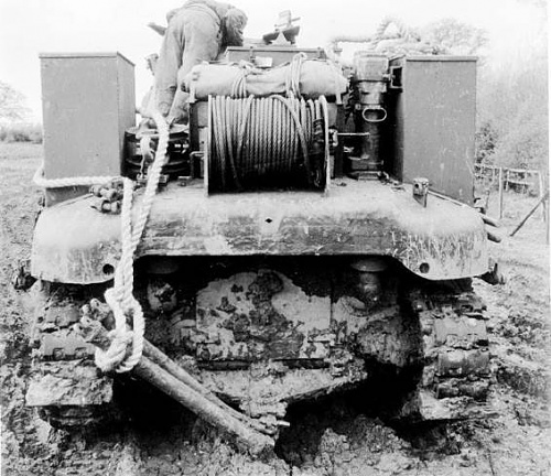

Ram ARV I, sadly the census number is unknown:
ID:	110687 Click image for larger version

Default Rect 159854
Roddy
Attached is a bad quality picture of Ram ARV II RECT 159854.
Clive Law's website Ramtank.ca is sorely missed...
Name:	Ram ARV II.jpg

Default Ram ARV Mk II RECT-159854
There may be some conflicting info in this thread, this is what I make of it:
Cruiser Tank, Ram Mk II, CT159854, Shop No.1399:
  • First assigned to 13 Tp, C Sqn, 12th (Canadian) Armoured Regiment (Three Rivers Regiment), Central Canadian Stocks & Central British Stocks. Named 'COBAULT' while a gun tank with 12 CAR. Records show it was at Worthing, UK with 12 CAR in March '43.
  • CT159854 was Struck Off Strength from Canadian Central Stocks to Central British Stocks in Jan 1944 and by 31 May 1945 under the WD number of 159854 had been converted as the pilot ARV II by the British. In photos this shows as RECT (Recovery Tank) 159854.
  • Also, as/at 31 May 1945, due shortages in British stocks of the Sherman, an order was placed to have 100 Ram Mk II tanks (out of their stock) converted into ARV II (based on this pilot model, RECT 159854). This order was subsequently cancelled in October 1945.
It seems this was the only Ram ARV II converted. David Herbert spotted the remains of one in a British scrapyard decades ago.
ID:	113841 Name:  file2469.jpg
Size:  95.4 KB Name:  ct159854.jpg

Hello David,
Thanks for sharing your sightings. I recall you telling me about that Ram ARV II at Cashmore's Scrapyard, not about the one at Sennybridge AT2 range.
It is confusing that the period documentation refers to Ram Mk.I and Mk.II ARVs which refer to the type of tank which was converted, rather than the type of ARV.
Attached is part of the listing of Ram tanks Struck Off Strength (S.O.S.) and transferred to the British Army in June 1945. It lists the census numbers of the ARVs converted from Ram Mk I and Ram Mk II.
