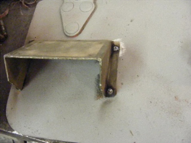

Old 25-10-22, 18:52
A very similar plate was added to the Canadian M2A1 (later designated C1) howitzer. Rather than a wooden block, there was a metal bracket added. The same plate was also affixed to the Canadian M109 self propelled howitzer.

Old 26-10-22, 04:58
Tony,
I don't remember seeing a mounting block on the L5 pack howitzer shield, .....
So I doubt the zero line plate shown here is applicable, but cannot confirm that 100%.
Gun ARN 02-090 in Puckapunyal Museuem shows the wooden block on the top left shield (facing from Crew side).
Gun ARN 02-087 (private collection) shows a different format plaque (later than as introduced, perhaps?).

Old 26-10-22, 05:33
Posts: 2,405
Default Thanks
Thanks Tony, just goes to show I should not rely on a failing memory! Different design of plate, of course, but essentially similar information.
