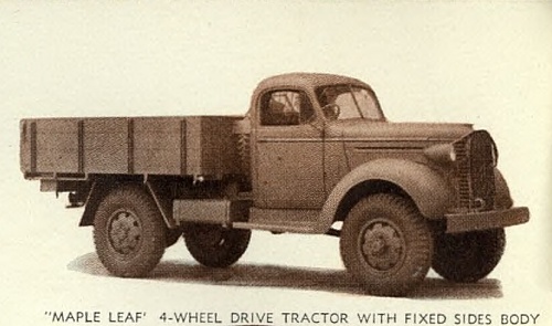

Spotted the 4x4 Maple Leaf. Was this a prototype?

GM had ready made running gear with the 1 1/2 ton Chev and the 4x4 GMC. It would have taken "5 minutes" to produce a Maple Leaf 4x4 using either of those as a base.

The thread Canadian Chevrolet Maple Leaf 4x4 artillery tractors? has some info on what this most likely is:
I have not heard before of Maple Leaf trucks being supplied to the KNIL. I have looked through my references and found a vehicle which fits your description in Bart Vanderveen's The Observer's Fighting Vehicles Directory World War II (revised edition), p. 233:
"Truck, 30-cwt, 4x4, Gun Tractor (Maple Leaf)
6-cyl., 80 bhp, 4F1Rx2, wb 134 in. The Maple Leaf was a product of GM Products of Canada Ltd and could be described as a heavy-duty Chevrolet. This unit was produced for Australia, where it was fitted with GM-H cab and fixed-side body."
The picture (sorry, no scanner) shows a chassis/cowl (front end sheet metal plus windscreen) on large (20"?) tyres and a spare tyre fitted behind where the cab would be.
As noted by Vanderveen, "this unit was produced for Australia", but I cannot recall seeing pictures or references of these in Australian Army use. Did GM Holden deliver vehicles to the KNIL?
Now with the picture from Vanderveen side by side with the finished truck:

The closed cab example has a GMH built cab fitted . Notice the rectangular vent on the cowl . Bart 's pic shows a Canadian made cowl by the look of it.
So what type of axles were fitted ? Did GM Canada manufacture 4x4 axles prior to building CMPs ?
Just notified the rear axle in Barts pic looks like a split axle housing
Also Barts pic is of a 1940 model ( side lights on the guards ) ,the closed cab is a 39 model

Fuel tanks are also different, Mike.

I believe that the four wheel drive components were supplied to General Motors by NAPCO, northwestern auto parts company. Marmon Herrington seems to be more associated with the Ford products.

Thanks Mike, so Konstantin's photo shows a 1940 or 1941 E8 Stores lorry. I was surprised to read it was fitted with Marmon Herrington FWD as they are normally associated with Ford vehicles as Paul said.
Now, we need to find more info about that elusive "Maple Leaf 4-wheel drive tractor with fixed sides body" shown at the top of this thread.
Old 04-11-22, 17:25
Posts: 2,390
Default 4WD Tractor
I agree with you, Hanno, that the MH-AWD is mostly associated with conversions to Fords. The Australian Government was buying the kits from the MH company from 1939 onwards, and having them installed by Ford Australia, mostly for the LP 1 to 7 and No.10 artillery tractors in 4x4 and 6x6. I've extracted all the artillery tractors I can find listed in AWM126, and their are no Chev/Maple Leaf modified conventional trucks among them unless I missed a whole bunch. (Always possible, of course - I missed C-6301!). The Bart V book image shows a very similar cab to the Australian Ford-MH LP series artillery tractors, which doctrine required have the open cab for observation purposes, whereas the GMH image shows a closed cab.
Maybe during the early stages of mechanisation in the late 1930s, the Aust Army experimented with both Ford and Chev/Maple Leaf conversions to AWD, which would fit with the 'Two Engine' Mechanisation Policy of the late 1930s, but then concentrated on Ford. Conjecture of course, as I've not found anything to support that theory, but it makes sense if you are seeking vehicles from just those two suppliers.

The truck is a 1939 model, behind the brush guard you can see the short or narrow upper grill panel. The long bullet shaped headlight bodies are another 1939 parts. The 1940 model has the wider grill panel and short stubby headlights.
The front axle hubs don't look like Marmon Herrington hubs to me, but GM-H may have modified the M-H hubs to suit the GM pattern wheels.
I am sure there were a small number of these unusual Maple Leaf 4x4's assembled, probably less than fifty.
