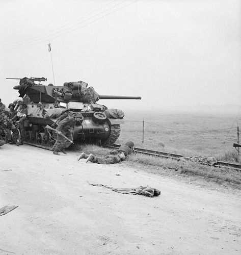

ID:	136974 Click image for larger version
Name:	3rd Canadian Anti-Tank Regiment.jpeg
ID:	136975 Click image for larger version
Name:	d-day-british-forces-during-the-invasion-of-normandy-6-june-1944-an-m10-wolverine-3-inch-self-pr.jpg
I think on the front is something like the example in the link below. It states it was telescopic with a height of 21 inches when closed, and could be raised to 90 inches.
https://thecanadiansoldier.com/produ...-radio-antenna
Name:	m10 hull side aerial.jpg
The mast on the hull side looks much heavier - was this the standard B type aerial, but In this instance sitting atop an extension?

Antenna on radioman's right would be a G Rod (24") on an extension (PC 767010)(24" +-). Top would have Aerial base No.9 for the G rod and the bottom dome is rubber secured with a flat ring bolted to the extension supplied. The bottom rubber dome allowed the barrel to traverse pushing the whole thing over. The mount also allowed the G rod to clear the clutter on the upper deck.
The F Rods were mounted on a bracket behind the headlight guard on front glacis radioman's side. No.8/10 base plus required F Rods.
WS19/22 would have been mounted in hull right front as the M10 was open turret TD.
Geoff

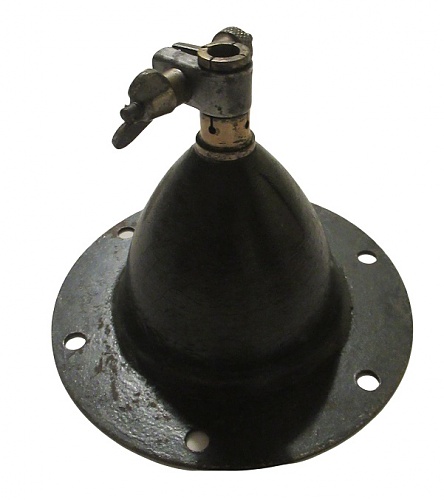

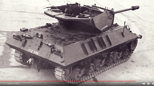

Geoff, thanks kindly for providing insight to the Achilles subject. Now I have some follow up questions. . .
First the G Rod on the hull side. What is the detail at the top as indicated in the cropped photo below.

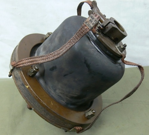

Found a similar looking rubber base which is described as the insulator, but maybe not the same thing as you have it being bendable if the turret/gun barrel is swung over the antenna?

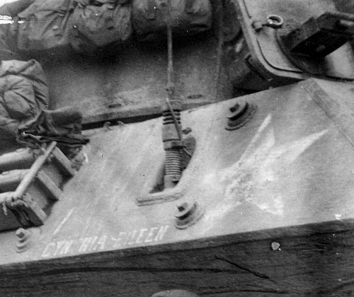

Now to the front antenna as the WS19/22. Suppose the main bottom portion could be 21 inch length when compared to the one located on the hull side. The diameter does not match and should be about double compared to the WS19 example found. Unfortunately cannot find a WS22 to compare with. . .
Name:	front glacis.jpg

Forgot to mention I had googled the part number PC 767010 for that extension but failed to find anything. Are there any images/diagrams known or some info on the diameter of that pipe?

Hello Jack.
I used to have an NOS Extension in my 19-Set stuff years ago but finally sold it off as I had absolutely no need for it. It was a specialized piece of kit is seems that had no place in the late war/post war Canadian Supply System for the 19-Set.
First time I have seen one in wartime use in your photos and at that, I am very suspicious it is mounted onto a steel tube adapter sitting between the rubber base of the extension and the hull of the M10. That adapter may be unique to the circumstances of installation on the M10 and perhaps, even a field mod to make everything work.
The extension consists of a molded rubber base cylinder with a circular flange at the base, held to the vehicle by a heavy duty steel ring using four bolts. the steel tube is vulcanized onto the top of the rubber cylinder via a small steel plate welded to the end of the steel tube. The ID if the tube is large enough to feed the B-Set Connector cable through it all the way to the top. The top which you have highlighted has a steel fitting welded to it. the lower portion is a small cup, large enough to hold the B-Set Cable Connector that clips onto the bottom fitting of the Aerial Base No. 9. The top part of this cup is identical in appearance to the tops of any of the steel post style mounts for the Aerial Base No. 9. That is, it has been machined to the correct OD and depth for the bottom of the Aerial Base No. 9 to sleeve down over it once the cable is in place and be fastened to the top of the extension with the four standard screws set at 90 degrees apart for this purpose. The shiny ring you see is the bottom of the Aerial Base No. 9 in place on top of this upper extension fitting.
The Insulator you posted a picture of looks like a main set aerial base for a wireless set that is not a 19-Set or 22-Set. Possibly a No. 9 or No. 11 Set...but do not quote me.
The photo you posted of the two aerial bases puzzles me. The forward mount assembly should be for the main set aerial for whatever wireless set was installed in the M10, but I have not seen anything quite like it before. Sorry.
Could this M10 have been set up as a Command Vehicle with two wireless sets on board?

Hello Jack
First photo the arrow points to a common WS19 part, a No.9 aerial mount used with all G Rod applications clamps, extensions, mounts etc.. Attaches with 4 small screws through its metal base, centre is rubber and flexible, top is metal and threaded for the G Rod.
Second picture is same idea as the G Rod extension bottom rubber; but two or three times larger. Picture shows mount used with D Rods (7/8" various lengths., for WS9, 11, 12 ?? and command vehicles.
Third photograph is poor. Might just be something in front of the aerial base 9/10 with F Rods mounted, (static up to four 4' rods, mobile only 2 rods were used). I think you can just see the bottom angle of the No.8/10 base
Mount in window labelled WS19 is antenna for CDN WS58, post war adjustable adapter, aerial base No. 8 (spring clamp) and an antenna cable.

Was looking over my folder of collected images, and it seems the aerial atop the extension located hull side was pretty much standard. Though did come across one photo that did not make use of the extension.
For the aerial on the front glacis, those with the thicker bottom stem seem to be present during first month or two of the Normandy campaign and only on the M10. The Achilles photos have on the front the simpler set A utilizing Base No8. They also seem to be located in one of two or possibly three locations on the glacis.
The colour photo below shows two pot locations but period photos only ever show one aerial ever being used on the front.
As for the M10/Achilles being a command vehicle equipped with two radio sets, it is not mentioned in the War Establishments. There was instead Universal Carriers used by troop commanders. These would be replaced with tanks were made available as Observation Posts in the form of Valentine or Crusader AA.
http://ww2talk.com/index.php?threads...tillery.23770/
Anyhow lots to chew on, thanks guys. Now on to find better detail images and hope to find some dimensions.

Those are standard WS19 aerial bases. The one on the tank side is the 'B' set Aerial Base No.9 on a Mounting No.3 (tall aluminium tube mount on a rubber base) fitted to a 'stalk' mounting of some kind on the tank. The mounting further forward is Aerial Base No.8 with Aerial Rods 'F' for the 'A' set.

Agreed. The 'B' set base is on an Aerial Base No.9 Mounting No.3 to get the 'G' rod above the turret roof line. I think the 'A' set aerial still has the remains of some waterproofing from the beach landing on it - probably a plastic tube and a lot of asbestos mastic to seal the ends (insulator at the bottom, aerial rod at the top) and keep the water out while wading. There's a discarded exhaust trunk in one photograph to hint at wading ashore....

Indeed yes that image with wading trunks lying in the foreground was taken on June 6th 1944. The M10s are identified as belonging to 3rd Canadian Anti-Tank Regiment.
Talk about going full circle about the antenna setup on the front glacis. That would explain why I could not find a proper modern photo with a thicker base stem, and the only closest resemblance turns out to be a "Horrible Bodge".

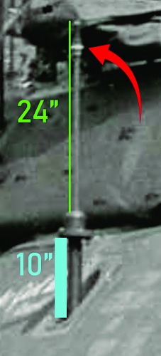

Is this where the G rod length measurement would lie as represented with the green line? The forum has its diameter quoted as 1/4 inch so the thickness of that green line is also scaled to match the length. Visually it seems the rod in the photo would be near double diameter and it does appear much heavier than the aerial located on the hull front.
Attachment 136990
Nope! The green line (10 inches visible) is part of the Achilles, and would be installed during construction ready for a wireless fit (likewise the shorter pillar on the front glacis plate for the 'A' set aerial). It will terminate in a circular flange with either four, five, or six holes depending on which "Aerial Base No.? Mounting No.?" is intended to go on top of it. In this case it's got Aerial Base No.9 Mounting No.3 fitted, which has a hollow rubber cylinder and loose clamping ring at the bottom, the central stalk is fitted to the top, and the top section is larger to match the Aerial Base No.9 (which fits over it and is secured by four screws) and Aerial Rod 'G' screws into the top of that.
The question is: can I put my hand on the one I've got at this time of night?
(Answer: No. Darn it all to Heck (in lieu of anything stronger - I must have moved it during the last sortout).
Back to the photograph... the tip of the red arrow is pointing at a white stripe; this is the nickel-plated inverted cup that is the start of Aerial Base No.9, and has a Pye connector in the centre with a pigtail lead that goes up to the (again nickel plated) top cap on the ribbed rubber insulator - the aerial rod screws into the centre of the top cap (2BA thread (I think)). The coaxial feeder (Leads, Aerial, No.2 ZA.3142 or No.3 ZA3143 from memory) is stuffed up from inside the hull, attached to the aerial base and the horseshoe shaped wire clip fastened, after which the clip is secured with some twisted copper wire and the base attached to the mounting with four screws. The aerial leads for the 'B' set are a tuned length and must not be shortened.
That mounting looks like the one I have (somewhere), and most of it is thin-wall duralumin tubing painted dark green (wrinkle finish) which makes me think it's USA manufactured.
The Australian version used a big steel coil spring instead of the rubber mounting at the base of the mount.
Hope this is some help, I'll continue looking for the mounting.
Not quite: the big insulator was originally Aerial Base No.3 for wireless trucks using the No.2 or No.3 set and Aerial Rods 'D' - as part of the 34-ft mast. Later on they were used on wireless trucks with serious high power transmitters (WS 12, 12HP, 33, ET4336, etc.) and the rubber insulator was not up to the job, so it was bypassed electrically with the four copper braid straps, and sat on a large mushroom-shaped ceramic insulator (Insulator, W/T, 'H') so that it could be fed from underneath - the No.3 required a wire to the terminal on top of the insulator. The combination was redesignated Aerial Lead-in No.16.
Use with the whole 34-ft mast caused the rubber dome to collapse under the weight, so a "skeleton cone" support was made that was inverted over the rubber insulator and locked onto studs on the top plate, the rods were inserted and a screw clamped onto the bottom rod to take the load off the rubber. Static use only, of course - it was a rigid assembly.
The final version was Aerial Base No.20 which did away with all the Base No.3 bits and simply had a rigid socket bolted through Insulator W/T 'H'.

The American use of the M10 required just the one antenna, and the hull side location was specifically made just for this. Their aerial base looks better designed to bend with the turret rotation.

Hello Jakko, thank you for stopping by and bring up those points.
I have read the reason the Army, or more specifically the Royal Artillery et al, did not adopt that name, since being gunners, they were primarily concerned with the gun type.
Anyhow another interesting variation of the B Set aerial where the bottom extension is not in use
Name:	Screenshot 2024-02-16 at 01-00-09 Tank Chats #88 Valentine Archer The Tank Museum.jpg
