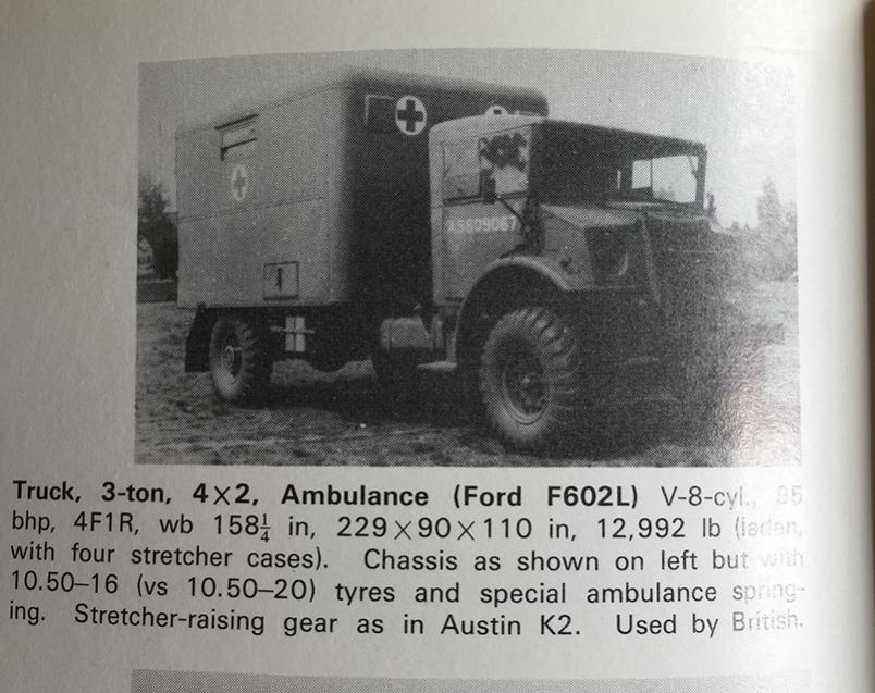

Default C298WFS Ambulance S/M 2972 spare parts list
Originally Posted by David_Hayward (RIP) View Post
I am adding to this comment the evidence that C298TFS chassis were exported under British contract to Australai and Egypt, etc., and thus would have been right hand drive. The photo just might be of one of the batch:
A 5809058 to A5809257 Contract SM 2972 "Ambulance 3- ton 4x2 4-stretcher"..note the Red Cross badge. If it's not then it's not a British order for the UK.
David Hayward also wrote: "C298WFS Ford V-8 3.9 4-spd 13’ 2” 3-ton replaced model C298TFS in 1945 model F-60428M and F602L"
This Illustrated Spare Parts List for the C298WFS as supplied on S/M 2972 turned up for sale in the Netherlands (not mine). Note the 1943 date - its seems the successor of the C29TFS came earlier than 1945.
ID:	139798 Click image for larger version
ID:	139799 Click image for larger version
A photo of the F602L ambulance:
