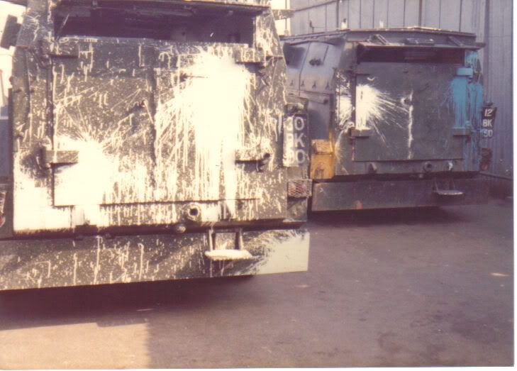

What do people make of this then?
Clive,
It looks like a Mk1, or in other words, not uparmoured. Unless it was made for a film job, I was not aware that Flying Pigs were anything else than Uparmoured versions. Another reason could be that it was from one of the training camps in England, as there was no chance of it being shot at, there. It looks like it has been demobbed as the census number has been removed, could be in a dealers yard?
Go on, shoot me down with a Malkara, probably wrong

Richard you are quite correct, this indeed in the normal meaning of things, a Mk 1. People seem to assume that a pig with a barricade pusher is a Mk 2 ie uparmoured which this clearly isn't.
This pig was one 200 recovered from dealers & scrapyards for use in N.Ireland. The barricade pusher was fitted to most of the Mk1s & Mk2s. The rams were designed also to be fitted to Saracens, though in practice this didn't happen. The EMER for this mod was issued in 1975.
This is the only Mk 1 Flying Pig I have seen ie fitted with defensive screens. The EMER for this was issued in 1976.
This pig has an unusual feature in that on the tops of the rear doors fold down. I assume that this would allow troops to observe and fire from the rear. There is evidence that there were rear facing seats to faclitiate this.
I have only seen one other pig with this type of rear seating & where rear door flaps had been fitted. It is in my garage, but on mine the rear flaps have been welded up. So it was not a success I assume.
I took the picture in an ordnance dealers yard about 20 years ago. There were several Mk2 Pigs, 20 Shorlands & 20 Salidins.

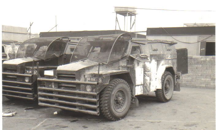

What's this then?

Originally posted by fv1620
What's this then?
Clive,
It would appear to be a RUC Pig, but the barricade bar on it is rather unusual.

This is the first type of barricade ram used on pigs. It is not only slightly snowplough shaped but its height is adjustable. Very ingenious.
But what model of pig is it & why do you say its an RUC one?
It has a NI civvy reg. number. At a glance I think it to be an early Mk1 ?

Yes it 3071 EZ. But when you say it is a Mk1. Do you mean as in production Mk 1 ie FV1611 or do you mean Mk 1 as in FV1609 like mine which is the true Mk 1 ?
Have you got green fly?
Clive,
That would be the FV1609 that the RUC were issued with.
Actually, no its an Army FV1611. Originally 13 BK 01 but modified for police service.
There were ten FV1609s issued to the RUC in late 1958. During 1960 they were all fitted with an armoured roof, loosely based on the FV1611. These pigs were in the sequence 2986 OI to 3001 OI.
In 1962 2986 OI was destroyed & replaced by this FV1611. Some modifications were made:
Windscreen visors with horizontal slits.
Strong wire mesh protection over windscreens.
Painted Light Admiralty Grey
Front & rear foglights
The characteristics that show it to be a FV1611 rather than a FV1609 are:
Rails on roof for canvas
Square not rounded headlight covers
Aerial base support is thicker
Fittings where wipers were fiited (on FV1609 they are inside)
Pistol ports are more substantial
Bridge plate
3071 EZ was fitted with an adjustable barricade ram & painted in Rustoleum Green. It always seemed to be the pig that was used in front line in preference to the other FV1609 based pigs of which some had barricade rams. Here it can be seen covered in paint & being petrol bombed.
A unique & interesting vehicle that then entered Army serice in 1971 with the registration 27 BT 91 and was struck off census again in 1980.

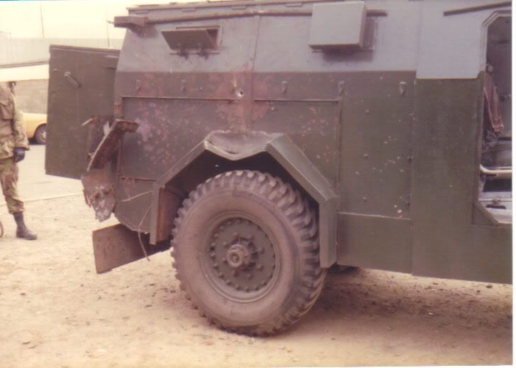

A couple more photos of the Pig in N.I the first trio show the differing types of crash clearance frames fitted, what is that thing poking out of the top hatch on the right facing the photo
Old 21-03-06, 10:12
Posts: 1,281
Second photo is a armoured ambulance
cheers

Nice shots there Les. Interestingly they are all Mk 1 despite the barricade rams which were fitted to both Mk1 & Mk2.
The thing at the top is a light, they were also fitted to Rovers.
The other stuff on the roof is a roll of barbed wire & a frame for a road sign for VCPs etc
The Mk1 ambulance is nice, but when it was uparmoured to Mk2 spec that one became an APC.

Chris now that brown camo is very interesting. One can see as late as 1972 Pigs at that time being Mk1 still with a European green/black. I had assumed it was just the way the came, I didn't imagine that it was repainted once over there.
But this green/brown has fascinated me. I have just one picture of it & have on video some footage shot from the commanders seat of a Pig on patrol in a housing estate. Both sources looked as if it was freshly painted which seem odd trying to look "rural" in an urban situation.
What has foxed me even more is that at least two of the exRUC Commer water canon were at one stage painted green/brown. I realise in RUC service they were initially light grey then many became green. In later part of service with 17/21st Lancers they were plain green.
So I wonder what was the rationale behind this reddish-brown camo in an urban environment?
Clive
Can't answer that one. As I said, I joined the resident battalion (2 Queens) about 3 months before they came back after a 2 year tour. The Bedfords were that colour too, with apple green (fireproofed) tilts with windows and an elevated (about a foot) centre bar on the tilt frame intended to get molotov cocktail ingredients to run off the sides. Have some pics of them too. Can't remember what colour the Rovers were. The point is that all those vehicles had been there some time, not imported from BAOR, but I have no idea when the brown bits were painted on, Tac signs were interesting too - red squares with 39/9 in white (39 Brigade), plus callsigns all round.
