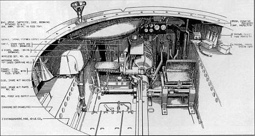

I urgently need (I'll explain later) as much as possible information re. the interior of the Ram Kangaroo. Presently I cannot access my printed references; the only information I have online can be found here - see pics below.
Can anyone add anything to this, please?
Thanks!

Just stowage as far as I can see, Hanno... while the crew's gear and miscellaneous crap will have been stashed outside the crew compartment, all task-related gear will have been inside, including a good stock of .50/.30 cal ammunition for the inevitable turret-ring Browning. This will probably have found an ad-hoc roost on the right sponson.
I'll see what else I have at home, but from your tone I suspect it may be too late by then; perhaps Bill can add something more substantive in the interim.

Every picture you have access to is virtually all the reference material we have. I agree with Geoff on the additional stowage. Some pioneer tools also stowed on the inside, shovels, crowbars etc. The LAD diaries mention moving the #19 set depending on the particular Ram model (models with the Aux. MG turret) but there is not much detail as to exact position. I'll see what I can dig up from the diaries tonight.
Bill.

Thanks for the replies so far. This saterday I picked up the parts to build the Kangaroo scale model. I took some measurements and several reference pictures of the Mill Kangaroo, yesterday. I won't bother you with more model related info, but I also received some new (?) interior drawings from Bert Lindeboom who also provided most of the parts for the model and I thought it was worth displaying them here.
