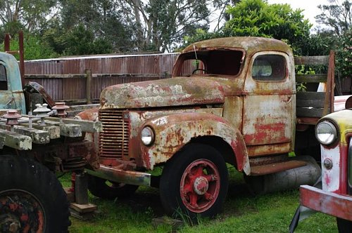

I'd certainly be interested in seeing if any spares might be available, locally or further afield.
This K-Series was one of a pair which sold on ebay last year for about $150 each, in a town about 70 km from me. I bought a blitz wreck from the same guy and he told me the Inter buyer was a collector, so he may be good for parts. Next time I'm down that way I'll drop in ask the seller if he still has contact details. I'd give him a ring but I no longer have his phone number.
Name:	TONY6586 - Copy.jpg

Thank you very much, Ron, that info is gold!
I was aware that the 18x10.50 was a trailer type, having seen it on a field kitchen trailer (I think) once before. I thought at least one variety of smallish Chev truck or ute also used them? I'll take your suggestions, and appreciate your having taken the time to reply.
You've described my truck perfectly, as shown in the attached pic;
"The roof and rear part of the cabin is all local stuff done in a hurry and cheaply. The cabin rear is usually wooden frame with sheet metal nailed and bent over the top. Some had canvass roofs and some had sheet metal."
I wonder if I'll be able to register it with new wood, rebuilt as it was originally done? Lots to think about.
I also attached a pic to show what a wash does, to remove sixty-something years of grime. There's no evidence of the ARN, but the paint is mostly good.
Matt

Thanks Ron, that photo gives great detail. The vehicles pictured are quite like mine, in roof profile, door shape, and general layout. It appears that mine has a different contour to the bottom edge of the wheel arches, and a rolled edge.
This pic is also interesting, given the wheels. I wonder what size they are?
I'm also fortunate in that all of my badges are still in place.
I visited the truck this afternoon, and took a few more detail shots of the remaining metal fittings, to get a better idea of what I'm working with. Loops down the side seem to suggest that it had drop sides, while the fittings on the forward bulkhead are largely intact.
The first pic shows one of the remaining uprights. It appears to be fabricated from channel, chopped and welded at the bottom. Those square nuts are interesting!
The second shot gives front wheel detail. Are these wheels like anything else out there?
The third shot has another quandry. The four rubber blocks between the glovebox and the instrument cluster, around the ignition lock mechanism, have me puzzled. Two are gone, but I can't see what they might've been used for. Someone mentioned rifle brackets, but I can't work out how that'd work. If these trucks did indeed have somewhere to rest a rifle, then I'm in luck, as I've collected Lee-Enfields for years!
Thanks again, and cheers!
Matt

Another win tonight. I'd never been able to open the passenger door, so I hadn't had reason to look at the floor between the seat frame and the door. Just happened to look, and saw the data plate.
I'm guessing that 233 refers to the 233 Green Diamond engine, as against the 214 Green Diamond. 159 is the wheelbase in inches. Pity there's no date.
Last year, I found the same chassis number on the chassis rail, and passed it on to Mike Cecil, who very kindly looked it up for me. Thank you, Mike.
Mike noted the following;
IHC Model K5, 159 inch wheelbase, 10:50x18 tyres; chassis number 25146; original engine number GRD233-34411, GS Lorry, Army registration number 43362. Sold to IHC per SAN959 (undated, so most probably end of war).
Fascinating. I have my work cut out for me!
Matt
