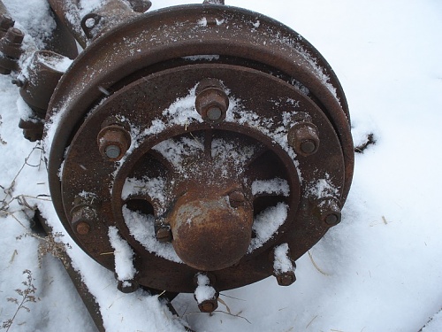

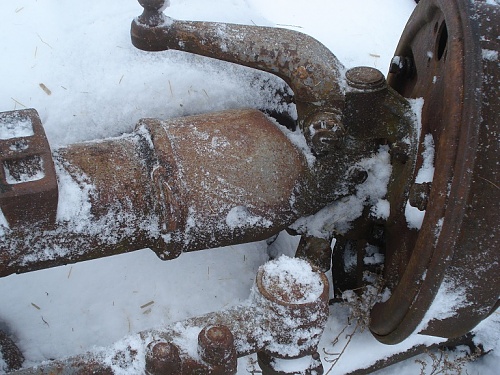

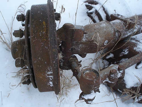

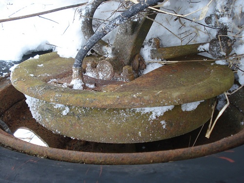

Took a spin out through the snow with my broom for a few photos,
first of the non driving front axle, second of the 41-46 ? maple leaf chassis.
May also have extensions availble will have to check in the spring.. BP
ID:	105831 Click image for larger version
ID:	105832 Click image for larger version
ID:	105833 Click image for larger version
ID:	105834 Click image for larger version
