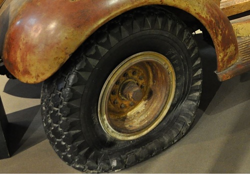

I am trying to figure out what size front axle, brakes, rims .... Rick used on his repro and what issues he had with the wheels. I know he found a set of Good Year All weather traction diamond tread 9.5 x 16 tires........ WHICH ARE STILL BEING MADE TODAY...... those are implement tires and I have a new set of Michelin 900 x 16 tires mounted ready to roll.
