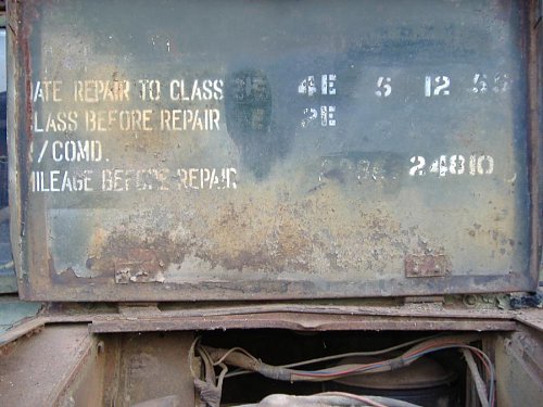

The truck was repaired to condition 4E at 24810 miles on 5 DEC 1955 for Northern Command.

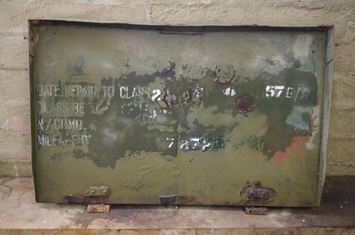

Well after three and a half years my C60L is home. I have now had a chance to examine the truck with my glasses on and with a magnifying glass and a few things are a bit strange.
First the engine has been changed a couple of times in the army life of the truck, the engine number on the data plate is DR4014304, the engine number in the War Memorial book is DR3750990, the engine in the truck is DR4014613, and is painted deep bronze green and I guess it is a army rebuild. I am happy with all that as the engine runs very sweetly.
There are about 6 different notations about repairs and reclassification stencilled under the bonnet/hood they start in 1953 and go up to Dec 1955, all with Northern Command, Queensland.
The manufactured date is 5-5-45 IND, originally I thought it was 1ND but now I am not so sure, funny thing the dashes between the 5-5-45 are actually the number 1 lying on its side. Could this truck have been made for India ? It was supplied under SM 6404.
The truck is deep bronze green as you would expect, and the paint is polishing up reasonably well for 60 year old paint, the ARN 77821 is painted on the top of the front clip, 3 times in 3 different styles, but on the bottom layer of brownish paint is the number 4004, it is stencilled on and done very well, quite thick, it is possible that there are numbers before the first number 4 but there is no room for anything after the last number 4. Could this be a Indian registration number? I will add at this stage that the ARN 77821 and the chassis number 4-8443-71597 tally with the ledgers at the Memorial.

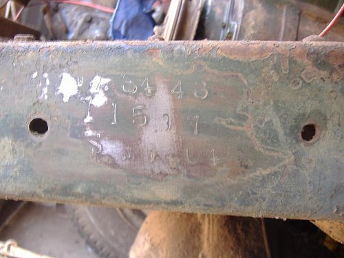

The left hand chassis rail is marked like this,
4X8443- which according to David Hayward should be X48443-
71597
SM 6404 I have never seen a contract number on a chassis before
Very likely IMO Ken, as I happen to believe your vehicle is ex-Indian Army. If that's true, then you've found the last 4 digits of the rego. The later Indian numbering system comprised the DoD broad arrow followed by two small digits, followed by 4 large digits (ie. 4004 in your case). Try rubbing back the upper area of the doors, you may find the entire Indian registration number. Also the bumper bar, on the RH end or in the centre. These are the usual locations for Indian registration numbers, however I've also seen them on the front shell occasionally.
It's my belief that quite a few ex-Indian Army CMPs found their way to Australia, probably including my own first blitz pictured below in 1973, and a number of late production FGTs identified in Australia recently. I have a couple of theories as to how this may have occurred, one of them being ex-BCOF vehicles, acquired in Japan when other forces departed. BCOF initially comprised Australian, British, Indian, and NZ forces, but by late '48 only Australia remained, and it appears they inherited quite a few foreign CMPs left behind, which can be seen amongst their own Australian built CMPs. Some of these went on to the Korean war in 1950, many of which would have returned to Australia following armistice in '53, while those remaining in Japan would have returned with the BCOF, which finished up in '52. That would tie in with your post war Northern Command service records, which BTW have also been found under two FGT8 bonnets, formerly NT Force vehicles.
I'll dig up some photos to illustrate the above possibility. I'm very much hoping you find Indian Army rego on this vehicle, as proof positive they exist in Australia.

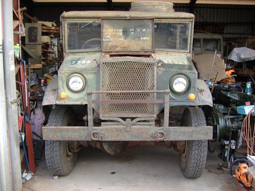

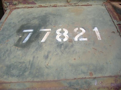

Well here goes.
ID:	69398 Click image for larger version
ID:	69399 Click image for larger version
ID:	69400 Click image for larger version
ID:	69401 Click image for larger version
Yippee I have done it sought of.

Default Wow
Well done Ken!
What a beauty and definitely an import!
In amazing condition too.

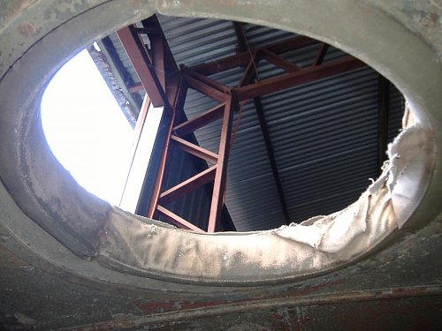

That's truly spectacular Ken! Amazing to see that hatch in Australia, let alone in such good condition. What a great story this vehicle must have to tell. Congratulations on a fabulous find, well worth waiting 30 odd years to acquire!
Nice to see that Northern Command stencil again too, it's very familiar to me. I wonder if our vehicles were stablemates at some time.

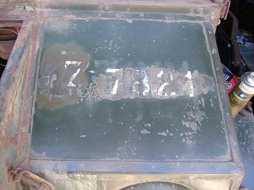

I take it you've done some rubbing back since these pics, do you have any showing the 4004 serial?

Tony,I forgot to put in I don't want to sand the doors as the paint is to good, there is nothing on the bumper, but interestingly when I was rubbing the dust from the 4004 for the photo, another set of numbers has started to appear under all the ones I have found so far.
I think Mike is correct and these trucks sat around getting painted a lot.
What do you think of the weird looking 7 at the beginning, it is really thick paint?
Ken

Old 03-12-14, 23:49
Tony Wheeler's Avatar
Join Date: May 2012
Location: Yarra Junction VIC
Posts: 953
If you rub back to the right of it Ken I believe you'll find another complete ARN stencil. Judging by the colours there were two complete repaints in Australian service, so I'd expect to find 3 separate ARN stencils. The two most recent ones are visible already, which means this 7 belongs to the original one.
I think you need to work on the lower serial, ie. the one you've just spotted. It appears to be the most recently painted IARN. The one you've already revealed is less than conclusive, mainly because the first digit is unclear (although I agree it's most likely a "4") but also because it looks to be from a different repaint, in a much larger digit size. The vertical looks way too fat to be part of the same stencil set, and as a "4" it's out of alignment with the 004. Maybe the correct "4" has already flaked off...? That's the problem with using a scraper, the flakes usually comprise several layers of paint, and you can wind up chasing the wrong digit. Based on my own experience I'd strongly recommend avoiding the scraper and sticking to wet rubbing only, working gently through each layer of paint, and taking lots of photos as you progress. For precision work on digits I use a folded corner of wet and dry, wearing magnifying spectacles. It's slow painstaking work but it's the only option when you have so many serial numbers superimposed. This is the trickiest one I've seen, you rarely if ever get so many serial number repaints, and they're usually above and below each other.
Fortunately the bottom serial is almost clear of the others, and with very little paint on top it should rub back quite easily. Also, since we already have 004 we only need to confirm the first digit, and check for anything to the left of it, which is hopefully the 2 smaller IARN digits. These appear to be in evidence already on earlier repaints, in particular what looks to be a small "4" jammed in at the left, possibly associated with the larger "4" stencil mentioned above. I'd expect the broad arrow to absent on the front shell, just like the pic below, as there's obviously no room.
I agree with you about the doors Ken, there's no guarantee the IARN is present anyway, as it was far from universal practice on these C6OL doors, judging by BCOF photos. Hopefully the front shell will yield a full IARN, without resorting the driver's side! Apologies for the bum steer on the bumper, I should have known it wouldn't be there on these vehicles.
Nice work on the bonnet, quite a bit of info there. I'm curious to know what "CLASS" refers to in this context. Interesting to see two stencils, which seems to indicate both repaints were Northern Command.
Anyway thanks for your all efforts Ken, it's priceless info you're providing here. I believe yours is the only IARN ever reported anywhere, and I'm pretty sure we'll never see another one!
