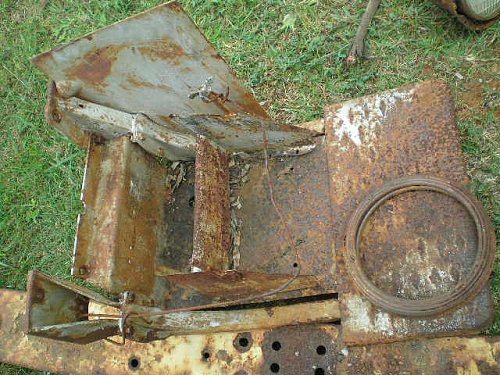

Hi Tony, Thanks for your kind comments. I have attached the reverse engineered drawings I made based on the photos and sketches that I was given awhile back. Was wondering how accurate they are based on yours? Info supplier never got back to me on how the base attaches at the rear of the holder hence I punted that there is a tab there. Also never got the thickness of the sheet metal. Brgds Jacques
battery holder.JPG   Copy of battery holder base.jpg   Copy of battery holder pattern.jpg   Copy of battery holder sides.jpg

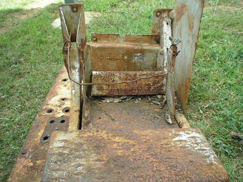

Default Battery Box
Jacques,
ID:	50487 Click image for larger version
Your drawings look virtually identical to my parts. Since I sent you the private message, it has started raining again, so I will have to check & photograph tomorrow. In the meantime, this is two photos I took of my battery holder assembly when I first got it. The box frame has been very badly treated in past, so my knocking it flat won't harm it any further. The two securing bolts have already been removed, and are in quite good shape. Good enough to be reused, and would be acceptable starting point for taking patterns off, if you don't have suitable replacements.
What is the part shown in your first diagram? It doesn't look familiar to me. Is it to show location of the box frame in relation to the base plate?
The only thing I see missing from your drawings are the exact location of the three rivet holes where the two battery securing bolts attach the battery box sides. I can supply that information , once I get a good look at mine. Mind you, you can't get them too far away from where they need to be, if you go off your plans!

Hi Tony, Thanks again for the info. The first drawing is what I reckon the base of the holder looks like and the spacing of the rivets that attach it to the sides and base plate. I assumed it is a separate piece based on the rivets on the tabs on the sides, or is it riveted directly to the base plate? (You can see I haven't been a draughtsman for 45 years-forgot to label the drawing, fail!)
The dimensions and position of the rivet holes that hold the battery securing bolts would be most appreciated. Again my previous source did not supply them, but in fairness, he was not a "Blitz" restorer. He supplied numerous photos which helped greatly and have attached a couple more here. The one of the front corner may be helpful for the little toe plate that keeps the battery in.
And I am right for the base plate dimensions. Mine is all there and in good condition. Often they are not from years of acid spllls from the battery so thanks for asking.
Brgds,
Jacques

Hi Tony,
Think I answered my own question! I remember getting the base plate straightened many years ago by the bumper straightening service where I took my bumper. I seem to remember now he mentioned grinding off some rivet heads. I had a look at my base and I can just see the outline of the holes. He did such a good neat job I didn"t see them before I primered and painted it. So I would say they were riveted directly to the base plate. The photos I obtained showed so much scale I assumed it was a sheet metal plate on the bottom. Have attached photo of my "interim" battery holder. You may find it interesting the Baldwin fuel filter element in it. The first truck had the remains of an AC GF-132 filter inside the filter housing. When I cross referenced, I found Baldwin makes one for it and bought it locally in Melbourne. I think it is a lot better filter than the original brass leaf type. And, just like the engine, I am willing to deviate from 100% original if it doesn't affect appearance but improves reliability.
Brgds, Jacques

Default Battery tray base
Yes Jacques, you are correct about the battery frame rivited to the base. My base has lasted far better than the box too. It also need a slight 'tweak' to straighten, but has no major pitting that might be a hole. Having said that, it is often only after sandblasting that these things appear. With this piece I am quietly confident though.
I will copy your photo showing the fuel filter, if thats OK? Every bit helps.
Will need to get back to you regarding dimensions, but first thougts are that they are quite correct. I will confirm this later this week.
I fully understand the decision to make slight 'alterations' or improvements in restoration. I like to think some of the changes I make are what Ford would have done if they were able to take their time and pay more attention to quality in construction
P.S: You Chev guys, they aren't built any better, I have been reliably informed.

By all means you can use the photos.
I chalked the rivet hole areas yesterday and was able to find the ground flush rivets and pop them out. (See attached). That gives me a pretty good idea of the correct overall dimensions assuming the tabs are 1/2" wide as originally given to me, and the rivets are spaced down the centerline of the tabs as they appear to be in photos.
I have revisited the photos I recieved over a year ago and have tweaked a few measurments of the battery holder. The notch at the sides is 5-7/8" from the base when I zoomed in. (see attached).
My old draughtsman eye thinks maybe the sloping front of the sides is exactly 45 degrees. (a nice convenient line for the designer to draw with the 45-45 triangle) Would you be able to check it for me if you have a protractor or square? The measurements I was given comes in close but not exactly 45 degrees.
One other question. What is the thickness/gauge of the sheet metal? Looks pretty thin. The photos look like it is only about 2 mm (14 ga)
Brgds,

Default Tony & Jacques
Too easy!
For what it's worth, the metal thickness of mine is:
Imperial 0.0595in or Metric 1.5mm
These measurements are on a section where there was minimal surface rust to increase thickness too much.
The angle Jacques was enquiring about is not 45 degree on my frame. It is just a little over 45.
Tony, I had already checked this afternoon, before I saw your email. Also your photo is exactly like mine, where as the photo Jacques posted on 14th, shows one with a shallow lip on the front. Which is correct???
Nothing is ever easy, is it!
Jacques' pic is correct - you and I have lost the front lip which is a separate piece. Looking closely at Keith's pic from the assembly instructions it appears to have a folded top edge, and the ends are folded around around the outside of the box, presumably spot welded to it.
Mine has been repaired in this area, with a new front lip being folded INSIDE the box, and roughly welded along the front edge. However you can see that the side has a cut away at the bottom to accommodate the thickness of the front lip, to make a neat flush join with the ends folded OUTSIDE. It's probably cleared on Jacques' pic which I've included here again.
The front edges of the box sides are recessed at the bottom to accommodate the thickness of the front lip section, making it flush with the whole front edge.
Actually it may not, it could be just an artifact in the photo. All the straight lines appear to have been retouched.
