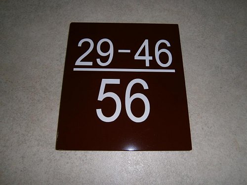

The unit sign would look similar to this.
Name:	TAC Plate - Unit side.jpg
The pic shows plate for 29/46 inf btn.
Check how bright the red background should be. This seemed right to me, but I have seen some darker/lighter red.

Old 22-05-14, 02:52
Mike Cecil Mike Cecil is online now
Posts: 2,388
Tony,
Looks much too dark to me - like a maroon colour. I think the colour used was actually 'signal red' - a much brighter red than that.
