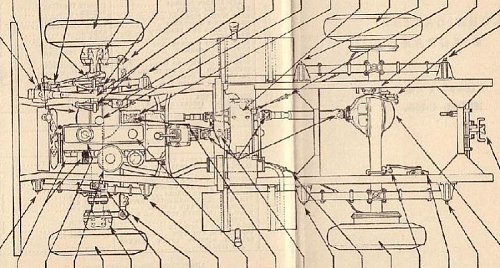

Who can help with some good views of the C60S and/or C30 chassis?
I found this plan view in the thread CMP chassis:
  1. Does anyone have a side view of the chassis? I am asking because I want to know if the chassis side rails taper towards the end (as on Ford chassis).
  2. Is the only difference between the C60S and C30 in the axles used? 3-ton axles versus 15-cwt axles and heavy versus light steering box?
Thanks!

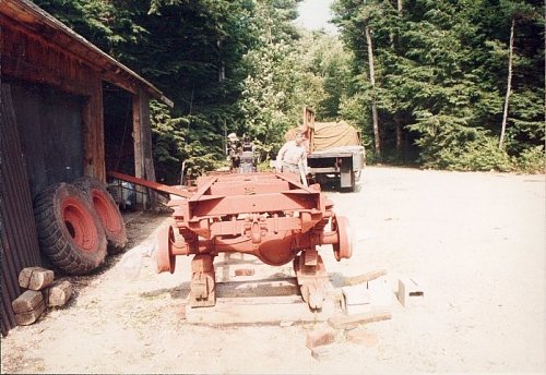

Default Pictures of my C60s Frame

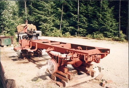

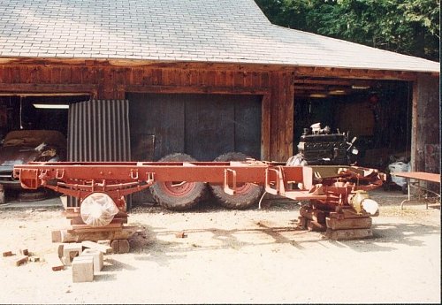

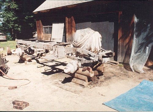

Hi Hanno
Here are some photos of the frame on my Pat 13 1942, C60S from its restoration in 1990.
Name:	W C60S Restortation -5.jpg
ID:	68783 Click image for larger version
Name:	W C60S Restortation -7.jpg
ID:	68784 Click image for larger version
Name:	W C60S Restortation -10.jpg
ID:	68780 Click image for larger version
Name:	W C60S Restortation -11.jpg
ID:	68781 Click image for larger version
Name:	W C60S Restortation -12.jpg
If you need a view of a particular section of the frame can probably blow it up and re-post.
This was back when I didn't have a shop big enough for a C60S.
Last edited by Phil Waterman; 02-11-14 at 18:13. Reason: Removed stuff already posted

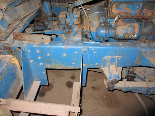

Now that we have the rail taper question solved, I would like to have some input on my 2nd question please:
I am trying to ID a Chevrolet: it is said to be a C60S, but it is on 10.50-16 tyres, which could mean it is a C30. But it does have helper springs on the rear axle and the front axle knuckle has 6 bolts on top. Can anyone help?

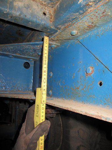

Hi Hanno
Do you need more pictures of C30 and C60 chassis,? I have good access to both (C60L with winch) plus cab 12 CGT in the barn at home.
Hi Niels,
Yes please: I need confirmation that a difference between the C60S and C30 is in the axles used, as in 3-ton axles on the C60S versus 15-cwt axles on the C30 and heavy versus light steering box?
Possibly Keith O. can confirm the type of axles and steering box used on the C30, too.
Thanks,

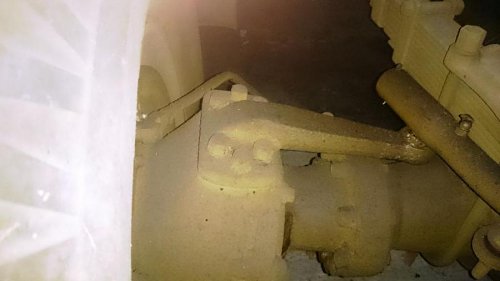

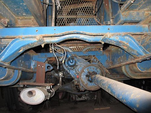

Not very good quality pics, but they show the 6-bolt steering knuckle ("heavy" or 3-ton axle) and rear axle helper spring. Tell-tale signs of a 3-ton C60S, rather than a 30-cwt C30, right?
Do 16" rims fit on 3-ton axles/drumbrakes?
Chevrolets are not my strong point, sorry
Thanks,

Hanno, I think it's a misnomer to describe CMP axles in terms of load rating. Certainly within the 60L/60S range there's no correlation with componentry such as steering ends or steering box. These appear to be nothing more than design upgrades - early production 60L/60S had small steering ends and steering box, while later production 60L/60S had large steering ends and steering box. I'm not sure exactly when the changeover occurred in Canadian production, but it's not seen in Australian assembly until mid '44, and even later in Indian assembly I believe, perhaps around mid '45. Hence a very large proportion of Australian and Indian assembled 60L/60S/FAT were fitted with small steering ends and steering box.
As we know of course, the 15A retained small steering ends and steering box universally, however I'm not sure that's true of the C30/F30. I've seen at least two F30 ambos in Australia with large steering ends and steering box. As far as I can make out, the only SPECIFIED difference between C60S/F60S and C30/F30 is wheel size. This gets back to our earlier discussion concerning CMP load class rating, which appears to based solely on wheelbase and wheel size.
On the question of auxiliary springs - they're definitely specified in the Ford workshop manual, and while it's not the most dependable source of info, you'd certainly expect auxiliary springs on the C30/F30 Derrick and LAAT. I'm not sure about the various ambos, but it occurs to me they may have been anomalous in many respects.
And yes, 16" and 20" wheels are fully interchangeable, with no difference b/w Chev and Ford.

Interesting discussion guys. Now, concentrating on Chevrolets for the moment as I am trying to ID a C60S or C30 on 16" wheels.
I just looked up some more facts in the Chevrolet MB-C2 maintenance manual and list my findings here:
Front axle:
6” steering ends (”steering arm is a separate part and attached to the lower part of the knuckle by six cap screws”): C60S, C60L, CGT
5” steering ends: C8A, C15A, C30, ”and on some special equipped C60L vehicles”
Brakes, front drum:
15” diameter, 3.5” width lining: C60S, C60L, CGT
14” diameter, 2” width lining: C8A, C15, C15A, C30
Brakes, rear drum:
15” diameter, 3.5” width lining: C15A, C30, C60S, C60L, CGT
Brakes, booster actuated:
C60S, C60L and CGT
Wheel sizes:
16” rims: C8A, C15, C15A, C30
20” rims: C60S, C60L, CGT
Differential gear ratio:
5.43 to 1: C8A
6.17 to 1: C15
6.5 to 1: C15A
7.16 to 1: C30, C60S, C60L, CGT
Springs:
As per factory specifications.
Winch:
Standard on CGT, supplied as optional equipment on C30, C60S, C60L.
Steering gear
Ratio is 23.6 to 1, with the exception of C60L with Gun Portee or Petrol Tank which has a ratio 30.6 to 1
C8A, C15 have mounting different from all other types
Old 07-11-14, 21:47
Posts: 14,928
Translating the above to identifying technical specs per vehicle type (limited to C30 and C60S as this the object of our discussion):
C30:
  • Front axle with 5” steering ends
  • Brakes, front drum: 14” diameter, 2” width lining
  • Brakes, rear drum: 15” diameter, 3.5” width lining
  • Wheel size: 16” rims
  • Differential gear ratio: 7.16 to 1
  • Rear spring leaves: 12
C60S:
  • Front axle with 6” steering ends
  • Brakes, front drum: 15” diameter, 3.5” width lining
  • Booster actuated brakes
  • Wheel size: 20” rims
  • Number of rear spring leaves: 12 + 6 Aux.
So the Chevrolet I am trying to ID is a C60S, by virtue of having:
  • 6” steering ends - see the picture with six cap screws
  • 12 + 6 Aux. rear spring leaves - see the picture showing the auxiliary springs
  • True, it is fitted with 16" rims, but it is possible to fit these on 15" diameter brake drums (C15, C30 have 16" rims on 15" diameter rear drum brakes)
Now, if I check if the subject vehicle has (had) a brake booster, I am sure this is a C60S rather than a C30.
Riddle solved!

Getting back to your question Hanno - the CGT frame is nothing more than a C15A frame. Unlike the FGT frame, which is a modified F15A frame, there's no difference between the CGT and C15A frame. Likewise throughout the whole CMP 4x4 range, because unlike Ford frames, all Chev frames were built with a winch crossmember. It's sometimes suggested the CGT frame is different by virtue of double skinned midsection, but that's standard on the C15A frame.
"there's no difference between the CGT and C15A frame".....
...... but for the rear end of the frame where the winch fairleads were fitted - compare with the C15A (left) and C30/C60S frame with winch (right):
ID:	69222 Click image for larger version

Pictures of chassis at datum points "C" and "D", plus dimensions:
Datum point "C" (at tip of pen), right hand external view (left) and right hand internal view (right).
Frame height is 20 cm at this point:
ID:	69602 Click image for larger version
Datum point "D" - the transfer case cross member - left hand external view (left) and left hand internal view (right).
Frame height is 20,5 cm at this point:
ID:	69604 Click image for larger version

Pictures of chassis at datum points "E" and "F", plus dimensions:
Datum point "E" left hand internal views; view from the front of frame member (left) and view from the rear of the frame member (right).
Frame height is 18 cm at this point. Note the frame reinforcement (inner frame rail) in the left hand picture:
ID:	69607 Click image for larger version
Datum point "F" at the rear frame cross member.
Frame height is 14,5 cm at this point.
ID:	69610 Click image for larger version

Distance between datum points "D" and "E":
Datum point "D" (left) and datum point "E" (right) - distance is 150 cm:
ID:	69612 Click image for larger version
