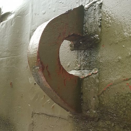

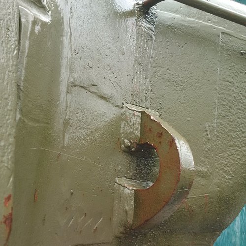

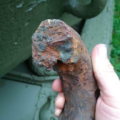

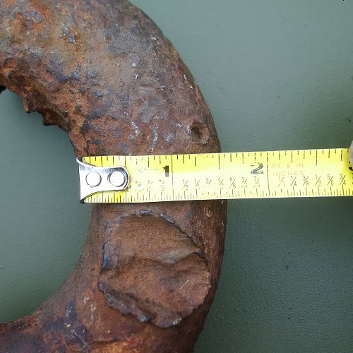

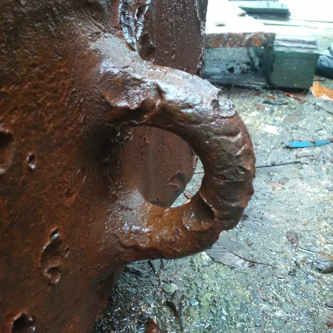

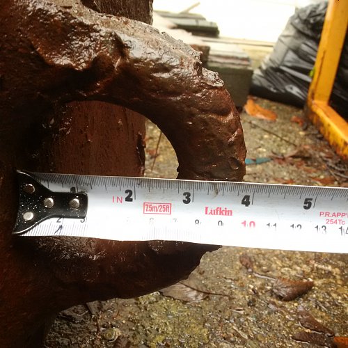

Would anyone happen to know the inner diameter and approx. steel thickness of the turret lifting hooks located on the rear sides of the turret? I'm guessing about a 3" diameter donut hole and a 1.5" thick cast steel ring. Never thought to measure one of these when I've been on the real McCoy. Thx, Patrick

Patrick this I a lifting ring on the M4A3E2 turret as well as one cut from the same model

M4 75mm turret
Old 02-12-16, 22:20
jdmcm's Avatar
jdmcm jdmcm is offline
Join Date: Dec 2010
Location: Surrey, BC, CDN
Posts: 672
76mm turret

Thank you very much for posting so many photos, they are all very helpful. it would appear 2-3/4" was common for the opening with 1-1/2" (3/4" radius) for the steel ring.
