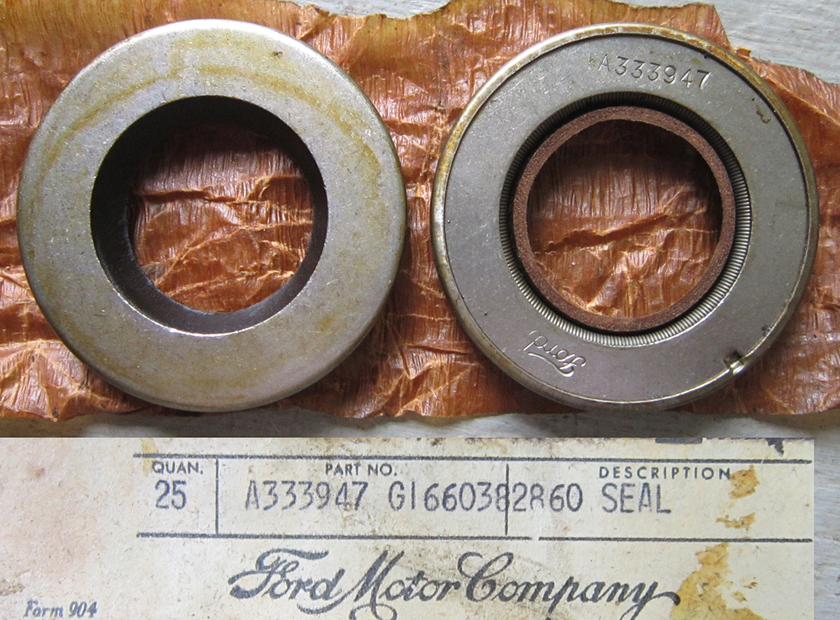

Still have a handful of NOS seals from when I restored the T-16 I used to own. Perfect time to replace them while you have the rear end opened up.
http://www.visualcollector.com/Tommy...DriveSeals.jpg

thanks David,
mine are in a really good state, no need to replace them
