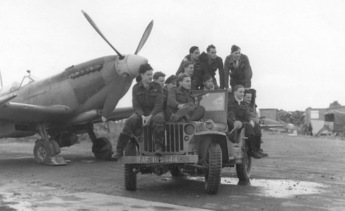

Sorry, not a RCAF Jeep, but an RAF one. At least it shows one can pile 12 pilots in a Jeep!

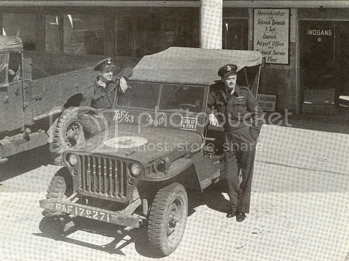

Gents:
I've had this photo on my hard drive for ages. I can't remember where I got it, but it looks like a copy of a DND photo. Caption says...........39R Wing-400 Sqn-Denmark-July 1945. Hope this helps.
Al Davis
ID:	119049 Click image for larger version
Name:	Screenshot_2021-01-11 Photobucket RCAFJeep-39RWing-400Sqn-Denmark-194 jpg.jpg
http://img.photobucket.com/albums/10...enmark-194.jpg
Al Davis

Al;
That would be correct, No. 400 Squadron, RCAF was a component squadron of No. 39 (Reconnaissance) Wing, No. 83 Group, Second Tactical Air Force, RAF, as per the markings in the photo TAF/83 39 R Wing
Mark

hi hanno.can you tell me where that picture is from with pilots.my uncle jim fiander was a raf fighter pilot and then was a squadron leader.the gentleman on the front of the hood is remarkable in appearance to my uncle jim.i wonder if you can email me the picture so we can get it enlarged.regards jim.
Old 26-09-09, 13:23
Posts: 14,969
Jim,
I found it on the internet sometime someplace and saved it in my G503 album. Sorry, I don't know any details. Hope this larger size helps you to determine it is your uncle Jim. PM your e-mail address and I'll send you an even larger sized picture.
http://www.surfacezero.com/g503/show...hp?photo=28272

Returning to an old post I have a question for Hanno and other Jeep fans. In British service in WW2 the sidelights on many Jeeps were typically moved to the mudguards, so I'm told as these lights needed to match the width of the vehicle for our road laws
However in the photo of the 'RAF' Jeep you posted with the pilots and Spitfire to one side, the side lights are still in their factory built location and the same is seen in the later photo of the RCAF Jeep from 39R Wing / 400 Sqn.
Could this mean that both Jeeps are in fact RCAF Jeeps that have been allocated direct to the Canadians? Or did we get bored with moving sidelights in 1944/45. Perhaps the Jeep numbers might reveal the production batch and who got them?
Lastly Hanno I think I have seen this photo before in a book on the 2nd TAF. I wonder if Jim Fraser ever found out if its his Uncle and what Sqn he was on. Your photo looks like the Sqn was operating 'in the field'.

http://www.servicepub.com/images/rcafjeep2.jpg
- M38A1, 67-07800, ex LETE
Old 23-02-13, 06:35
servicepub (RIP)'s Avatar
Posts: 1,734
Note the roundel. No Canadian markings but the photo comes from the RCAF archives collection
