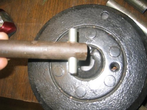

I spent a little time today facing the water pump seal . There must be lots of ways to do this type of job, I used what I had . Took about .010" off the face .
I plan on using a modern mechanical seal , instead of the 1940's era seal. The modern seals have a hard ceramic face, and they perform much better than the old seals .

Before I continue with the description and pics . This mod to my water pump was done without any permission from anybody. It is my pump and I do with it as I wish.
That is enough sarcasm from me .
I decided to ditch plan A and go to plan B
I bored out the pump housing on my mill/drill, using a home made boring head .
The seal is a two part seal as used in swimming pool pumps and fire fighting pumps and myriad other applications , these seals are easy to buy and are known as 'mechanical seals ' . I used a 5/8" seal .
Any machine shop can do this simple mod .
The last thing is to machine up an adapter for the ceramic seal, to fit it into the impeller
Thats it

Old 04-06-15, 16:09
Default Yes 235 water pump conversion requires moving the pully
Hi Mike
As you mentioned
"I have seen the pump kit for the 235 conversion, I think the 235 engine is slightly longer than a 216 and the fan can be too close to the radiator in some vehicles "
yes this is why I had to remove and press on a different pulley.
My experience doing the conversion on the 261 and 235 was that the block is not longer it is the extra 1/4" of the adapter plate plus the positioning of the and shape of pulley on the later 216 water pumps. The new or rebuilt water pumps that I was using all had the the narrow style pulley that I removed and replaced with the old style pulley flange and pulley.
As to the domed piston, ran into this when I rebuilt the engine on my HUP a few years ago, needed a new head because mine had some cracks developing, they had not leaked yet. The only NOS head I could get was for the flat topped pistons which meant I had to change pistons, not a problem as the cylinders were being bored which the pistons had to be changed. Pictures of the piston and head http://canadianmilitarypattern.com/H...May%20Work.htm
Be careful of how you remove or drive on the crank pulley real easy to deform the hand crank boss. Made a tool that fit in the center hole and put the driving force across through the hand crank slots this way when pulley is driven on it doesn't damage the boss.
Name:	Crank Pulley Tool.jpg
