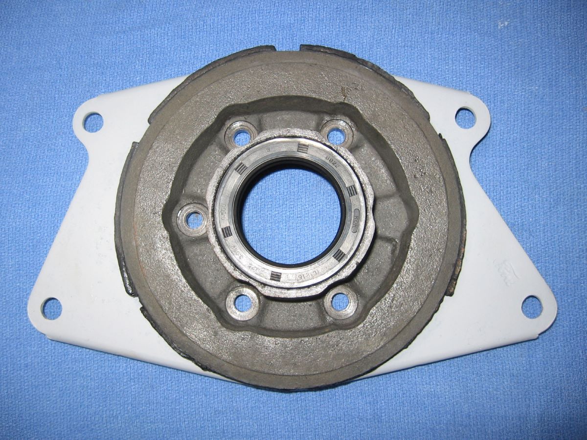

Applicable to the Otter, C15TA and I believe the Fox AC and C60X transmission.
4.319 2075286 Seal, Mainshaft Rear Bearing Cap Oil
Modern SKF / CR 17645
