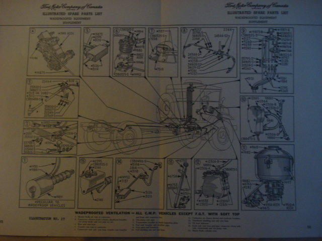

Hi Eric,
Here some pictures from the cover in color and the part numbers
of the air connection between the air cleaner and the support on
the roof of the cab.
The flexible tube was going through the hole in the dogs house.
