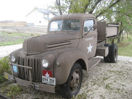

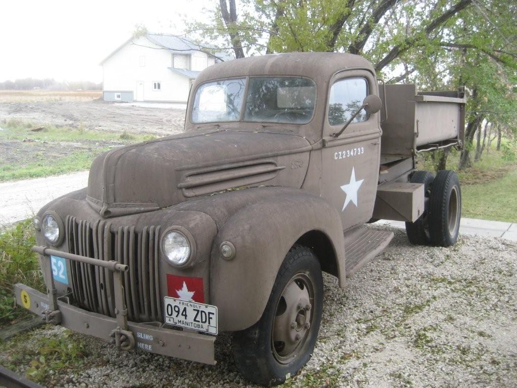

And here is a picture from Vanderveen showing the Canadian-built 1942 model Ford FC60L (or C298TFS), a 3 -ton 4x2 GS truck with 158in wheelbase and 95-hp V8 engine and a two-speed rear axle.
It had typical MCP features like right-hand drive, 10.50-16 tyres on British split rims and a Canadian-built cargo body.

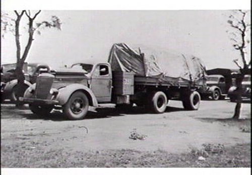

Default International MCP's
more Aussie trucks

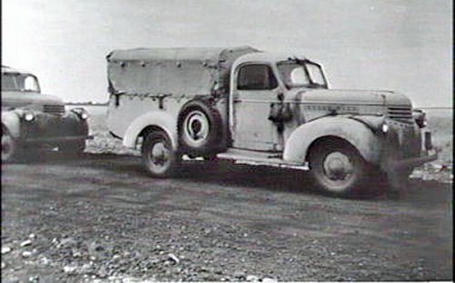

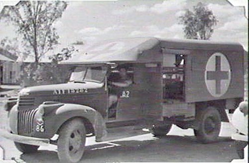

Some MCP (Ford, Chev and Dodge) pics from the Aust War Memorial site:

In THIS THREAD, Hanno Spoelstra showed these pics which show the difference between the Commercial Ford in Military trim (2G8T), and the Modified Commercial Pattern Ford (FC60L).
Old 22-05-11, 23:10
Default Second pic
Your second pic is a MCP cab on a C15A chassis, an interesting conversion indeed.

There are contemporary photographs of 1940 4X4 Maple leaf MCP trucks , apparently assembled by GMH . There is one in the Vanderveen bible , 72 edition. A GM version of the M-H No.3A more or less . As far as I know, no survivors have been found . I have also seen pics of them in that GMH history book they published just after the war... so they definately did exist , but technical specs. are vague at this stage .
No 4x4s, but THIS THREAD discusses GMC/Maple Leaf/Chev trucks in the Civvy and Military versions.

Ford Canada produced both the Commercial and Modified Conventional Pattern.
The big giveaway for the latter are the British specs like RHD and the 16" WD split rims (under widened fenders) as seen in the picture below:
The Commercial Pattern, albeit modified for military use, was used at home in Canada, hence the LHD. Derk's truck shown below shows typical military features like matt paint, military bumper, push bar and towing eyes, but it does not have black-out lighting and it has standard commercial wheels and axles with five stud brake drums:
http://www.alfrules.com/derk/IMG_7204.jpg
