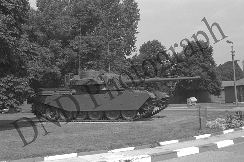

Default Centurion Mystery
Does anyone know the fate of this Lahr Centurion Mk 11 Gate Guardian?
Name:	Lahr Centurion Mk 11.jpg
