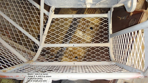

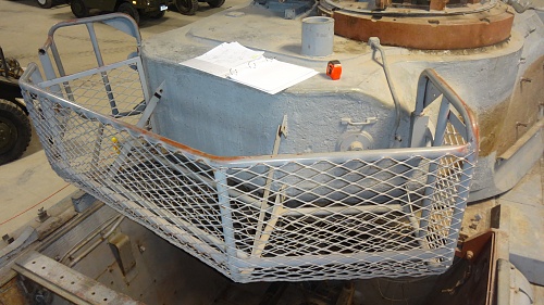

John,
Next installment. Outer wall of bustle is vertical despite apparent angle in first photo.
Malcolm

The grenade boxes are usually lined with thick felt, and on the exterior have a stencil stating to fill the bottom with cotton waste to pack the grenades to a reachable height inside the box, depending on which grenade type is being stowed.
Interesting the IR basket is mounted with bolts to lugs on Canadian Cents. The original Brit design was on pins so the (empty) basket could be lifted off. I also notice the internal bracing, which was a modification to overcome the basket sagging from over-loading.

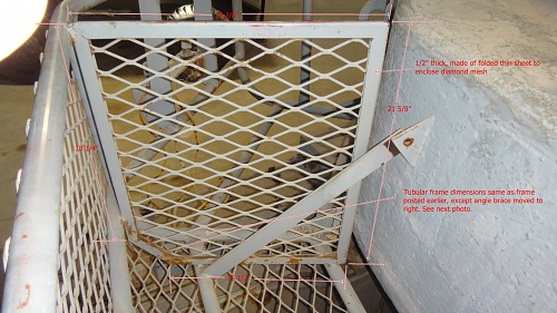

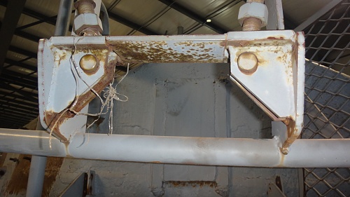

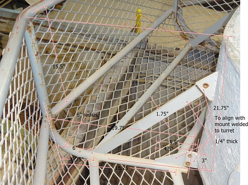

The first pic is an overview so you can make sense of what I'm posting (I hope).
The next three are the left hand side of the basket with dimensions.
Do you have the same lugs welded to the turret?
Malcolm

Malcolm
looks like a variety of different brackets, but re-creating those will be simple, great blueprints! Much appreciated!

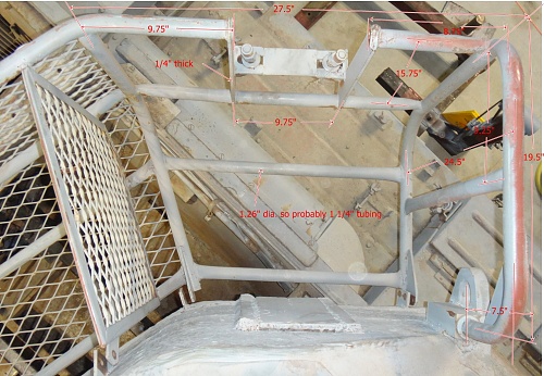

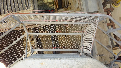

John,

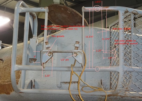

Last installment, the IR spotlight storage part (you don't have to have one spare, do you??)
I measured the tubing diameter with calipers. It's 1.260", so it's 1-1/4" tubing rather than 1" pipe.
There is good symmetry in support frames mounted radially to the turret. The two end ones are pretty well the same dimensions, with one having diamond mesh. The two inner supports are the same except for the angle brace being moved on the left one.
Good luck.

Thanks Malcolm! Is it the IR light you need? I may have a line on another
