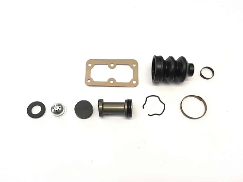

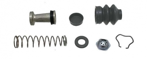

Default Rebuild Kit for Ford master brake cylinder
Ford master brake cylinder, 1 1/4" bore: current part number of a Rebuild Kit is 91T-2004-A, 91T-2004.
These kits seem to be quite easy to source in the USA, Canada and the UK, but I could not find a rebuild kit closer to home - until I remembered this:
If you have a Ford Master Cylinder needing a rebuild - the seals and pistons etc. are the same as on other American trucks like the Dodge WC-series for example.
As Dodges are very common here in The Netherlands it was much easier to buy a rebuild kit off the shelf, e.g. at Staman Trading:
https://staman.nl/product/kit-repair...ylinder-dodge/
