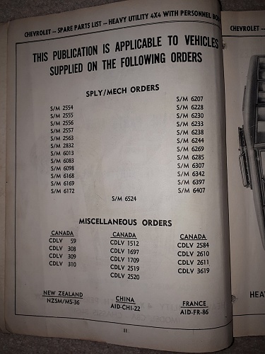

Question: could someone with a copy of C8A-04 Illustrated Spare Parts Manual for the C8A check the order numbers referenced in there, please?
I read that the June 1945 version of C8A-04 lists 41 contracts, both British S/M and Canadian CDLV (or LV).

Default C8A04 - 41 contracts
Thank you Mr Hupmeister!
Interesting to see the list of British SPLY/MECH (S/M) orders, and the list of miscellaneous orders for Canada, New Zealand, China and France. The last two were a surprise to me.

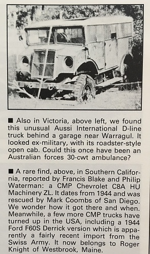

Default Mark Coombs' C8A Mach ZL-2
Chassis model | Cab Model | Chassis serial | Engine serial | Order no | Date of mfg | Vehicle model | Body Model | Body serial | Chrysler Serial-no | WD census no. | Source
C8A | 13 | 3844536671 | FR3969368 | LV.2611 | MAY 11/44 | ... |... |... |... |... | http://www.mapleleafup.net/forums/sh...671#post129049 (Mark Coombs, USA)
Here's a picture from Wheels & Tracks magazine of Mark Coombs' C8A Mach ZL-2:
Originally Posted by Brian Gough View Post
Phil,
Would you be thinking of Mark Coombs of San Diego? He has a Mach ZL-2, serial 3844536671, built May 11/44 on contract LV2611. It was pictured in W&T 44, p. 45 - actually Bart Vanderveen credited you for first reporting on it.
Mark came to Oshawa a few years ago and saw all the HUPs here that we could find to show him. I too have no direct contact with him recently and I don't think he is around on this Forum.
Brian
